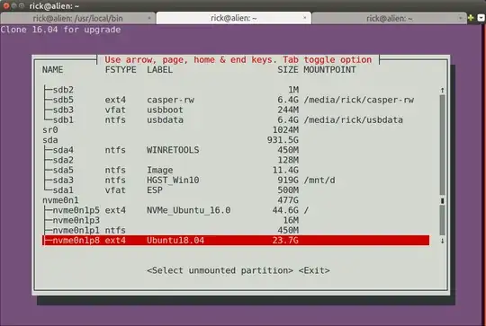

  • You must create an empty ext4 partition large enough to hold a Ubuntu 16.04 clone
  • When calling the script clone-ubuntu.sh the partition cannot be mounted. The script automatically mounts and unmounts the partition.

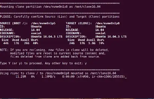

Confirmation Screen
After selecting a target clone partition it is first verified to be ext4 partition type and is not already mounted. If this test is passed, a confirmation message then appears:
Mounting clone partition /dev/nvme0n1p8 as /mnt/clone16.04
===================================================================== PLEASE: Carefully confirm Source (Live) and Target (Clone) partitions
SOURCE (BOOT /): /dev/nvme0n1p5 TARGET (CLONE): /dev/nvme0n1p8 ID: Ubuntu ID: Ubuntu RELEASE: 16.04 RELEASE: 16.04 CODENAME: xenial CODENAME: xenial DESCRIPTION: Ubuntu 16.04.3 LTS DESCRIPTION: Ubuntu 16.04.3 LTS Size Used Avail Use% Size Used Avail Use% 44G 17G 26G 40% 24G 17G 5.8G 74%
NOTE: If you are recloning, new files in clone will be deleted, modified files are reset to current source content and, files deleted from clone are added back from source.
Type Y (or y) to proceed. Any other key to exit:
In this example a previous clone has been selected for recloning. The available space on the clone is a mute point because we already know there is enough space available.
If you have multiple Ubuntu installations, please verify you have selected the right partition to clone the currently booted Ubuntu, mounted as / (root), to.
This is your last chance to abort by pressing any key except y or Y.

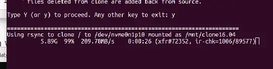

rsync status display for new clone
When cloning for the first time, rsync will give an update from 0 to 100% of all files created. No files will be deleted or changed as the clone is empty:
rsync status display when recloning
When rsync reclones it never hits 100% because files that never changed are not copied. There will be delays in the update progress as rsync scans for the next file to be copied and when it deletes new files created in the clone that never existed in the original:
