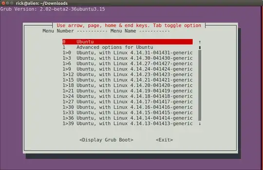

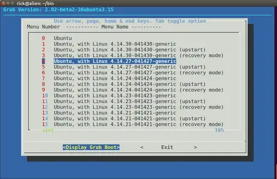

This update introduces grub-menu.sh a much superior version to previous answer (still available below). The new grub menu features:
  • Displays grub 2 menu entry numbers. ie 0, 1, 1>0, 1>1 ... 2, 3
  • Default short version without (upstart) and (recover mode) submenu options can be set.
  • Parameter 1 can be passed as short or long to override default.
  • column headings dynamically formatted based on short or long setting.
Color Screen shot (short version)
grub-menu.sh
Text Screen shot (long version)
Grub Version: 2.02~beta2-36ubuntu3.15

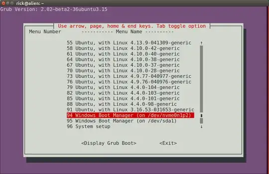

grub-display.sh displays grub menu options and parameters
Without relying on third party applications you can use a bash script to display the grub menu and the boot parameters for any given option. The boot parameters are more than just the cat /proc/cmdline values. They also include the drivers loaded before Linux is booted.
grub-display.sh bash script
Here is the full program listing you can copy and paste:

Screenshots
Here's what it looks like when invoked from the command line. Unfortunately I was not able to copy and paste the menu and had to use Print Screen:
Turn off mouse support for copy & paste
       ┌──────────Use arrow, page, home & end keys. Tab toggle option─────────────┐
       │ Menu Number  ----------- Menu Name ----------                            │
       │ │    0   Ubuntu                                                        │ │
       │ │    1   Ubuntu, with Linux 4.14.30-041430-generic                     │ │
       │ │    2   Ubuntu, with Linux 4.14.30-041430-generic (upstart)           │ │
       │ │    3   Ubuntu, with Linux 4.14.30-041430-generic (recovery mode)     │ │
       │ │    4   Ubuntu, with Linux 4.14.27-041427-generic                     │ │
       │ │    5   Ubuntu, with Linux 4.14.27-041427-generic (upstart)           │ │
       │ │    6   Ubuntu, with Linux 4.14.27-041427-generic (recovery mode)     │ │
       │ │    7   Ubuntu, with Linux 4.14.24-041424-generic                     │ │
       │ │    8   Ubuntu, with Linux 4.14.24-041424-generic (upstart)           │ │
       │ │    9   Ubuntu, with Linux 4.14.24-041424-generic (recovery mode)     │ │
       │ │    10  Ubuntu, with Linux 4.14.23-041423-generic                     │ │
       │ │    11  Ubuntu, with Linux 4.14.23-041423-generic (upstart)           │ │
       │ │    12  Ubuntu, with Linux 4.14.23-041423-generic (recovery mode)     │ │
       │ │    13  Ubuntu, with Linux 4.14.21-041421-generic                     │ │
       │ │    14  Ubuntu, with Linux 4.14.21-041421-generic (upstart)           │ │
       │ │    15  Ubuntu, with Linux 4.14.21-041421-generic (recovery mode)     │ │
       │ └────↓(+)──────────────────────────────────────────────────────16%─────┘ │
       │             <Display Grub Boot>       <      Exit       >                │
When the default mouse support is enabled, you can't copy the screen to the clipboard but must use Print Screen for a graphical screen snapshot. In order to support copy & paste you need disable mouse support by searching for these lines:
    --default-item "$DefaultItem" \
    --no-mouse \
    --menu "Menu Number       ----------- Menu Name ----------" 24 76 16 \
The argument --no-mouse has been inserted below --default-item. This means you loose mouse support but gain better resolution and copy to clipboard ability by highlighting text and pressing Ctrl+C.

The grub-display-lite.sh bash script is basically the same as grub-display.sh except there is no error message if dialog isn't installed. Also some whiptail arguments have different names.
grub-display-lite.sh screenshots
The colour screen seems to be easier to read than grub-display which uses dialog package:
Here is the text based image which needs no modifications to copy to clipboard:
        ┌─────────┤ Use arrow, page, home & end keys. Tab toggle option ├──────────┐
        │              55 Ubuntu, with Linux 4.13.9-041309-generic   ↑             │
        │              58 Ubuntu, with Linux 4.10.0-42-generic       ▒             │
        │              61 Ubuntu, with Linux 4.10.0-40-generic       ▒             │
        │              64 Ubuntu, with Linux 4.10.0-38-generic       ▒             │
        │              67 Ubuntu, with Linux 4.10.0-37-generic       ▒             │
        │              70 Ubuntu, with Linux 4.10.0-28-generic       ▒             │
        │              73 Ubuntu, with Linux 4.9.77-040977-generic   ▒             │
        │              76 Ubuntu, with Linux 4.9.76-040976-generic   ▒             │
        │              79 Ubuntu, with Linux 4.4.0-104-generic       ▒             │
        │              82 Ubuntu, with Linux 4.4.0-103-generic       ▒             │
        │              85 Ubuntu, with Linux 4.4.0-101-generic       ▒             │
        │              88 Ubuntu, with Linux 4.4.0-98-generic        ▒             │
        │              91 Ubuntu, with Linux 3.16.53-031653-generic  ▒             │
        │              94 Windows Boot Manager (on /dev/nvme0n1p2)   ▮             │
        │              95 Windows Boot Manager (on /dev/sda1)        ▒             │
        │              96 System setup                               ↓             │
        │                   <Display Grub Boot>        <Exit>                      │
As mentioned above you can reduce the size of the grub menu displayed here by 66% when removing (upstart) and (recovery) menu options. Such is the case here but as a consequence the detail lines get narrower and the headings don't line up perfectly. You can tweak the column headings by changing this line:

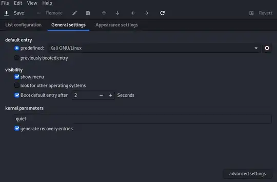

This is what you need, it also has other options.Use Grub Customizer. a.k.a. sudo apt install grub-customizer.
An alternative way to have a preview of grub menu (not so powerful as the most voted answer, but I think it may be useful to add this alternative) is to install the package grub-emu (it is available in Ubuntu repository) by running in a terminal the command: sudo apt-get install grub-emu
According to https://packages.ubuntu.com this package is for sure available since Ubuntu 16.04, and still available now that I'm running Ubuntu 20.04.
One remark: in order to navigate the menu with the keyboard, you need to have the window terminal from where you run grub-emu in foreground.
See the image: keeping the terminal in foreground, you can use the arrows and Enter buttons the check every item in the list. To close grub-emu you can press 'c' and then write 'exit'. I use it to check my color settings (when I'm tired of them and I want to change them) and to check the timeouts (for item activation when no iem is selected)
