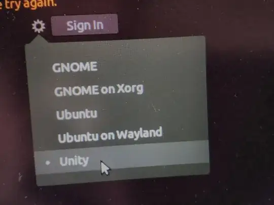

  1. After upgrading you must reboot.
  2. Make sure you sign-on selecting Unity from the drop down gear menu:
  3. After signing in the first thing you must do is open a terminal and run:
    sudo apt update
    sudo apt upgrade
