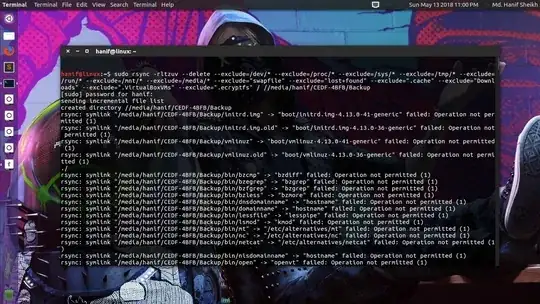

When I run either of these commands, I get the error rsync symlink failed: Operation not permitted (1):
sudo rsync -aAXv --delete --exclude=/dev/* --exclude=/proc/* --exclude=/sys/* --exclude=/tmp/* \
--exclude=/run/* --exclude=/mnt/* --exclude=/media/* --exclude="swapfile" --exclude="lost+found" \
--exclude=".cache" --exclude="Downloads" --exclude=".VirtualBoxVMs" --exclude=".ecryptfs" /source \
/destination
or
sudo rsync -rltzuv --delete --exclude=/dev/* --exclude=/proc/* --exclude=/sys/* --exclude=/tmp/* \
--exclude=".cache" --exclude="Downloads" --exclude=".VirtualBoxVMs" --exclude=".ecryptfs" / \
/media/hanif/CEDF-4BFB/Backup
Neither of these work. They both show the same error:
console
Can anybody help me to get this backing up properly?

As you used the option -l or --links preserving symlinks, I suspect that you tried to copy symlinks to a FAT partition, which does not support symlinks, independently of rsync.
