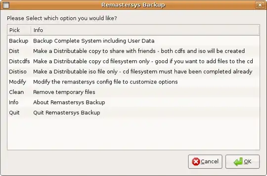

You can use Remastersys to create a bootable live CD/DVD image. This will install like a normal Ubuntu CD.
To install Remastersys, you first need to add a repository:
deb http://www.geekconnection.org/remastersys/repository karmic/
You can then install it from the Software Centre as usual.
Once installed, use it to make a 'dist' backup. This means that user data will be excluded from the ISO image.
remastersys UI
This is often used to create custom distributions but is still useful for the backup task you have in mind. One caveat is that it may fail if the contents of / (minus user data in /home) takes up too much memory because the ISO file format can only hold ~4GB data. Remastersys uses a file system called squashfs to compress your data so you should be OK with up to ~8GB.

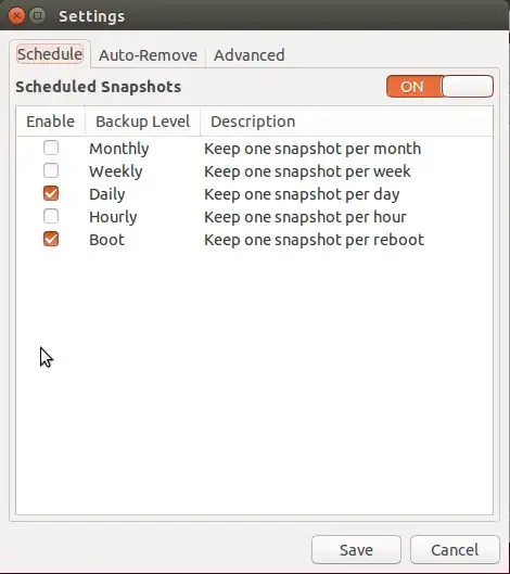

TimeShift.
TimeShift protects your system by taking incremental snapshots of the file system at regular intervals. These snapshots can be restored later to bring your system to the exact state it was in at the time when the snapshot was taken.
Open the terminal and run the following command
sudo apt-add-repository -y ppa:teejee2008/ppa
sudo apt-get update
sudo apt-get install timeshift
Screenshots
