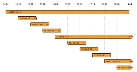

Automatic kernel updates in LTS release are enabled by Hardware Enablement Stack only.
Ubuntu Kernel Release Shedule
Here you can see that no kernel upgrades in LTS were done unless HWE enabled.
Ubuntu LTS Kernel Support Shedule
Here you can see that only security patches have been implemented.
Ubuntu Kernel Support Shedule

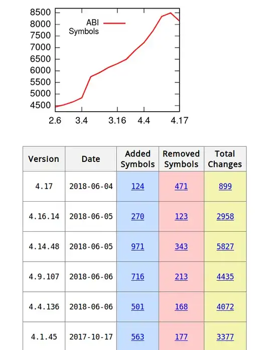

Tracking ABI/API changes
From the ABI Labratory we can see the last changes were on June 4, 5 and 6th, 2018:
We can see the Linux Kernel numbers revised in June 2018 were:
  • 4.14.48, 4.9.107 and 4.4.136 all 6 year LTS kernels
The corresponding Ubuntu Kernel version numbers were probably:
We need to upgrade Linux Kernels when new hardware support or bug fixes to existing hardware are released. When an ABI/API change is involved the Ubuntu kernel may or may not work. Even if an ABI/API change doesn't take place the Ubuntu Kernel may still break for some people for other reasons.
