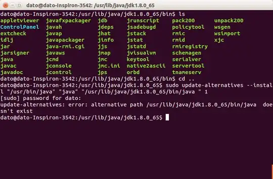

I'm trying to install JDK on ubuntu 14.04 LTS.
I downloaded it from oracle website. Than I extracted it and moved in usr/lib/java.
It says java doesn't exist but it does.
I use this video https://www.youtube.com/watch?v=NZB3Iy7Lve4
