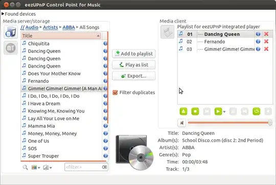

eezUPnP
Java based application - download the zip file (32bit or 64bit) and run ./CP in the extracted folder.
Obviously you need a JAVA JRE to be installed.
Be patient for the media servers to be recognised...
