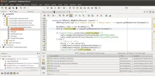

Download and install netbeans from hereenter image description here Now you will need to install the NetBeans Mobility plugin, which provides support for J2ME development, and the Sun Wireless Toolkit (WTK), which provides the actual libraries to compile against.
