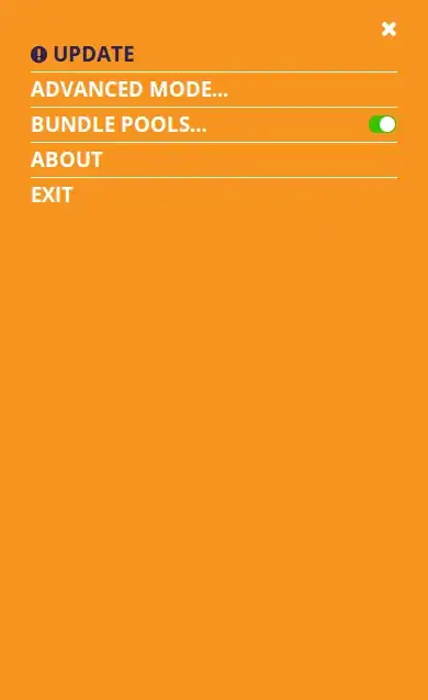

  4. Run the installer WITHOUT sudo to UPGRADE the installer
    ./eclipse-inst
    • Note the yellow exclamation mark in the top right corner.
    • Activate the hamburger menu to upgrade the installer.
    • Close the installer after the upgrade

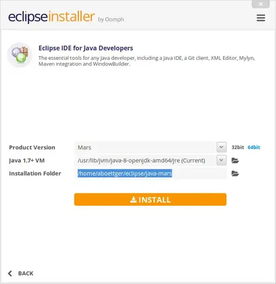

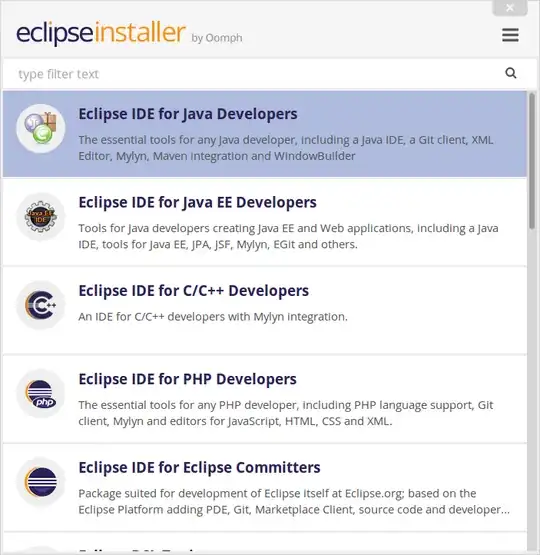

  5. Install Eclipse without OR with sudo rights
    • Without sudo to install Eclipse in your home folder
      ./eclipse-inst
      • select your Eclipse distribution
      • and use a path inside your home folder

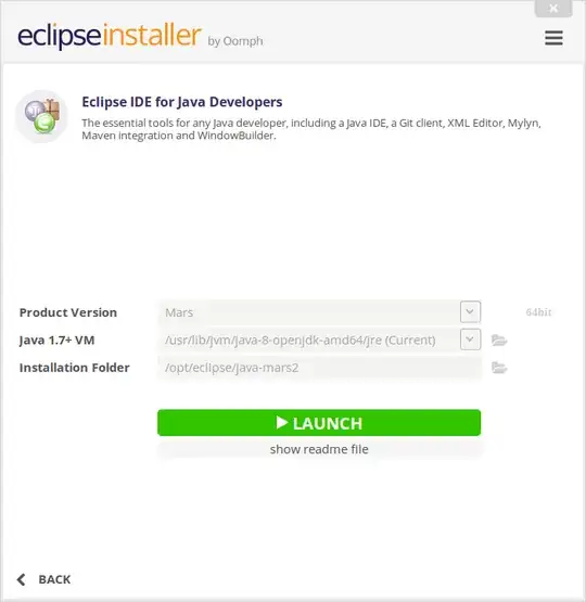

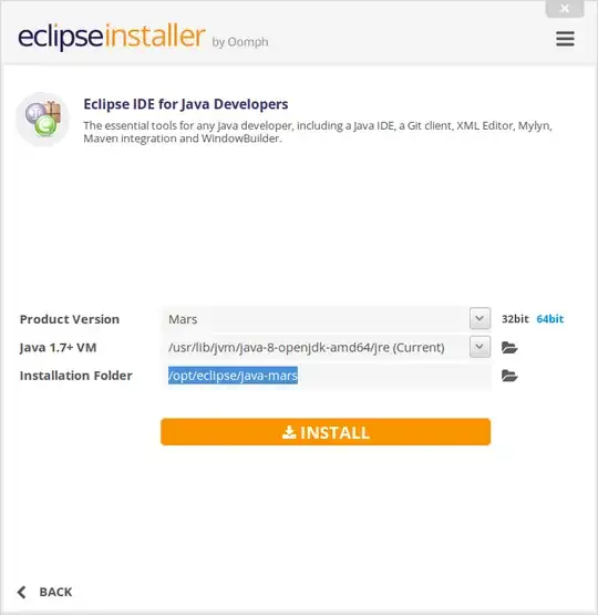

    • OR with sudo to install Eclipse in /opt.
      sudo ./eclipse-inst
      • and use /opt as installation path
  6. Finished

Unfortunately I don't have enough points to write a reply to the above answer by A.B. There is only one more step that you need to take if you want to install the application for all users under /opt:
You need to switch to the advanced mode and change the bundle pool folder to something like /opt/eclipse/.p2/pool. This is because when installing it with sudo, the installer chooses /root/.p2/pool by default for the bundle pool location, which can't be opened by your user. After that you should be able to open eclipse from your regular user. Hope this helps.
