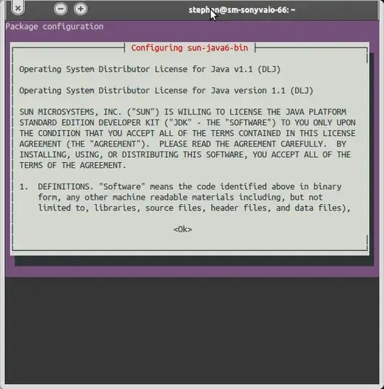

ok - you are using a PPA that when installing producing the following screen.
I looks like you closed this screen unexpectedly causing the package manager issues.
Restart the package installation via
sudo apt-get install -f
When you get to this screen, press the TAB key or possibly the arrow keys to navigate to the OK button. Press ENTER
This will allow your installation to complete successfully.
