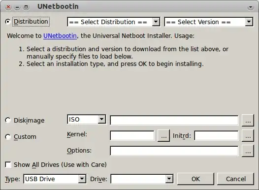

UNetbootin Install UNetbootin allows you to create bootable Live USB drives for Ubuntu, Fedora, and other Linux distributions without burning a CD. It runs on Windows, Linux, and Mac OS X. You can either let UNetbootin download one of the many distributions supported out-of-the-box for you, or supply your own Linux .iso file if you've already downloaded one or your preferred distribution isn't on the list.
Support amongst others: Ubuntu (and official derivatives) 8.04 LTS 9.10 10.04 LTS 10.10 11.04 Daily CD Images, Fedora 10, 11, 12, 13, 14, Rawhide and lots lots more.
If you look at them image you can choose distro's or download ISO's yourself and add them or add a custom. And you can set this up on a hard disc or a USB flash drive.

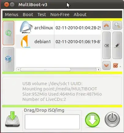

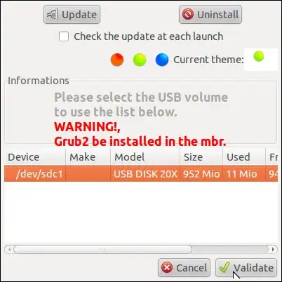

The only system I found for a multi-boot boot-stick, without using Windows, is Multisystem. While the documentation is only in French, you can easily install it on Ubuntu using the project's official repo:
sudo apt-add-repository 'deb http://liveusb.info/multisystem/depot all main'
wget -q -O - http://liveusb.info/multisystem/depot/multisystem.asc | sudo apt-key add -
sudo apt-get update
sudo apt-get install multisystem
It can do burg, syslinux, grub4dos, plop, Virtualbox, qemu etc., but a basic multiboot stick can be made in 5 minutes by drag and drop for many distros. For Slitaz cooking I had to add a few lines to /boot/grub/menu.lst. From what I read Grub 1 is usually used for a multiboot environment, but this one uses Grub 2. It can be run from the Windows boot menu by using EasyBCD or the Plop boot-manager.

I came to know 2 more tools. Named MultiSystem and YUMI.
MultiSystem installation is very simple, and you can easily install it on Ubuntu using the project's official repo:
sudo apt-get update
Then all you have to is select your USB device and simply drag n drop your ISO's into MultiSystem tool. If DnD doesn't work, you can also click on the Add button.

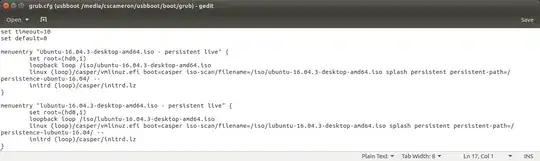

You can loop mount isofiles directly with GRUB2 by installing it to the MBR of the USB drive. You can also create UEFI bootable USB drives this way or combine both methods.
Most of the other solutions are MBR/legacy PC specific and don't work reliably on UEFI machines.
I recommend reading the documentation on the project site and related manpages (grub-install, grub-mkimage).

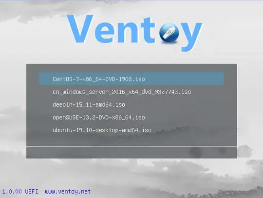

A solution tested from Ubuntu 20.04 and later is to use Ventoy. Directly from the tool description:
Ventoy is an open source tool to create bootable USB drive for ISO/WIM/IMG/VHD(x)/EFI files. With ventoy, you don't need to format the disk over and over, you just need to copy the image files to the USB drive and boot it. You can copy many iso files at a time and ventoy will give you a boot menu to select them. Both Legacy BIOS and UEFI are supported in the same way. Both MBR and GPT partition style are supported in the same way.

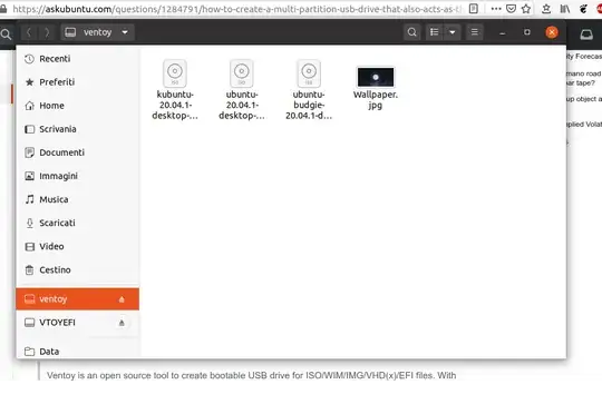

I have created a bootable USB where I have copied my ISO files simply with a copy/paste procedure, so that they are shown in a menu when the USB stick is used as a bootable drive. At the same time, I can use this USB also to store my personal data (they do not appear in the Ventoy Menu).
This means that when I use this USB stick as a bootable drive I have a menu like this (screenshot taken from the official website):
ventoy menu
When I open it via Nautilus, it is like a normal USB stick where you can put your files (screenshot taken from my Ubuntu 20.04):
nautilus
Ventoy does not come in a deb format or with an installation script, so you need to download Ventoy from the release page. If you download the .tar.gz version (I'll refer to version 1.0.61 in the following examples), you can extract it by issuing in the terminal:

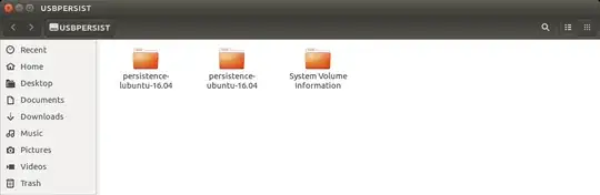

MultiBootUSB is my favorite multiboot drive maker.
It will make a USB drive that can boot over 150 distros, it is based on grub2 iso boot and is very easy to use.
Ubuntu versions and derivatives can each have there own persistence file. Persistence is not available in other multiboot drive creators.

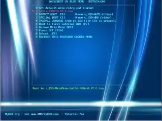

YUMI (2018)
YUMI now has a version for BIOS boot and a beta version for UEFI boot.
YUMI meets the OP's criteria for multi booting ISO images.
It is straight forward and easy to understand and use.
The boot menu is actually syslinux, but is similar to grub2.
One advantage of YUMI is that with a NTFS install, the individual casper-rw persistence files can be over 4GB each.
Download - https://www.pendrivelinux.com/yumi-multiboot-usb-creator/

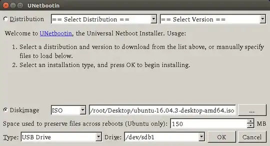

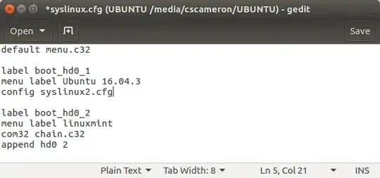

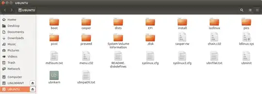

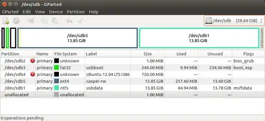

UNetbootin - Multi Boot
There is some interest in this thread about using UNetbootin as a multibooter, UNetbootin does not boot ISO images or install Windows OS.
UNetbootin can install to multiple partitions, however the syslinux bootloader must be dealt with.

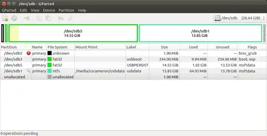

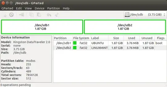

Gparted
Divide flash drive into one partition for each OS, Label partitions for clarity.
UNetbootin 1
Use UNetbootin 655 to install OS's to available partitions. using 655 or later should allow drive to boot both BIOS and UEFI
UNetbootin 2
Install to first partition last, or set boot flag for first partition manually.
Syslinux Package
Copy Chain.c32 from Syslinux-4.07 package to root of first partition. Syslinux-4.03 chain.c32 does not work.
Ubuntu Partition

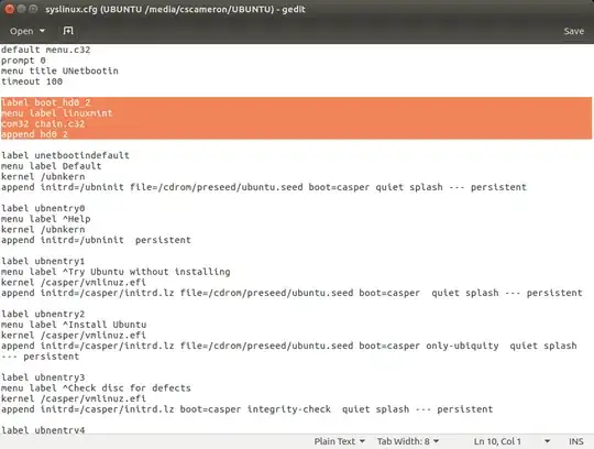

Copy syslinux.cfg as syslinux2.cfg.
Edit Original Syslinux.cfg

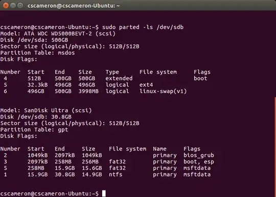

Replace the contents of the original syslinux.cfg as shown, adding a chainload entry for each OS.

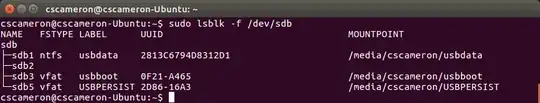

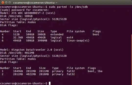

sudo parted -ls /dev/sdb
sudo lsblk -f /dev/sdb
Config does not seem to be working in the Linux version of UNetbootin 655, if you do not want to use the Windows version here is a workaround.

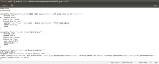

Edit syslinux.cfg to include chain loading command
Forget syslinux2.cfg and just edit original syslinux.cfg to include chain loading command for other OS.
Will update post if/when I figure out how to get chain loading working with UEFI, which may not be easy with syslinux.

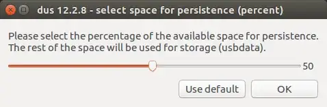

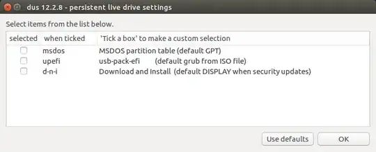

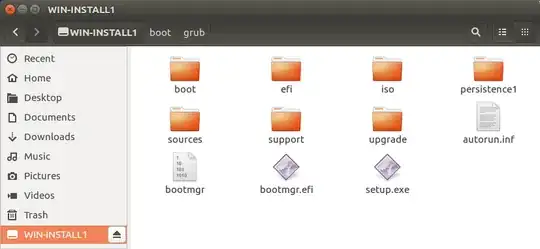

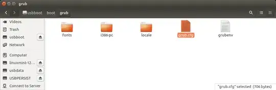

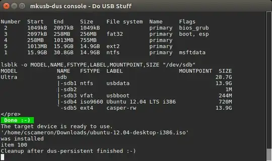

mkusb MULTIBOOT HACK
Mkusb makes a great base for custom boot drive projects because of it's abilities with both BIOS and UEFI.
This hack boots multiple ISO files including the Windows installer, and has a grub2 menu.

mkusb defaults
Use mkusb defaults when creating the Persistent USB drive.
mkusb use defaults again
Use mkusb persistence defaults if in doubt, partition size can be adjusted later but takes time.
DUS Console
The DUS Console after install.
GParted Before
GParted before partition modification.
Gparted after
Gparted after modification - Overwrite sdb4, the ISO9660 OS partition and sdb5, the ext2 casper-rw partition, with a FAT32 partition for persistence files.

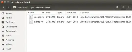

Persistence partition
Persistence partition - Create an uniquely name folder for each OS, (that requires persistence)
Persistence folder
Persistence folder - Add a casper-rw file and optional home-rw file to each persistence folder. A home-rw file can be made by renaming a casper-rw file. A home-rw file is like a seperate home partition on a Full install, it can be reused after version upgrades.

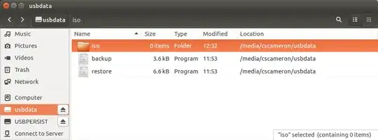

ISO folder
Create a folder for the ISO files on the NTFS usbdata partition.
ISO folder contents
Add some ISO's to the ISO folder.
GRUB location
grub.cfg location
grub.cfg
Edit grub.cfg to loopmount the ISO files. Include: persistent persistent-path=/<persistent-folder-name>/ if you want persistence.
If a Windows installer is required it is possibly easiest to start with the mkusb "extracting Windows installer" function, (I had to extract the Windows ISO to TAR manually),
mkusb Windows Installer
After installation create a folder for ISO's and if required, folders for persistence, (similar to above procedure).
mkusb Windows grub
Edit /boot/grub/grub.cfg to loopmount any ISO's and specify any persistence folders.
(have not found a way to loopmount a Windows ISO file).

Try Ventoy https://www.ventoy.net/
Runs in Linux and Windows, and accepts ISOs of both. Couldn't be more simple to use! After installing and running, just drag and drop the ISOs you want to the USB drive.

new answer for an old thread
After trying many solutions, among with
  • Multisystem an incredibly complex setup to reach a botched, flawed and mildly working interface
  • Yumi more professional approach but doesn't handle UEFI
I came to try successfully Easy2boot which has a simple and efficient Linux script to format, build and setup a preformatted USB drive (partition FAT32)
  • Uncompress the downloaded file from the site to a directory, say easy2boot
  • Copy your image files (ISO ...) to easy2boot/_ISO/AUTO (the simplest)
  • cd easy2boot/_ISO/docs/linux_utils
  • run fmt.sh : bash fmt.sh
  • easy2boot will show which device it will work on, and ask you if it is correct ... be sure to check this part twice!
That's it.
Try the formatted drive from Ubuntu! (should be unmounted at this point)
qemu-system-x86_64 -machine accel=kvm:tcg -m 512 -hda /dev/sdX
where X is the USB drive device (eg 'b','c',...)
You should get a new entry in the top menu "DIRECT BOOT".
