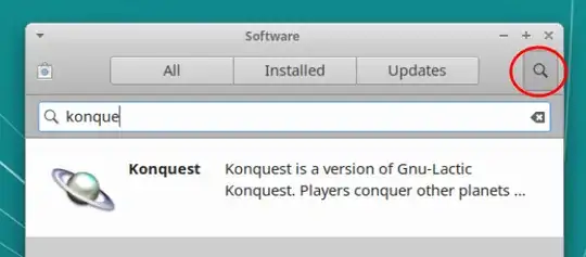

1: As pointed out in comments, there's a little magnifying glass icon. Click on that to get a search bar:
Search bar location

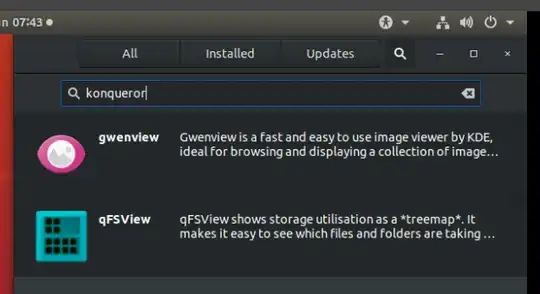

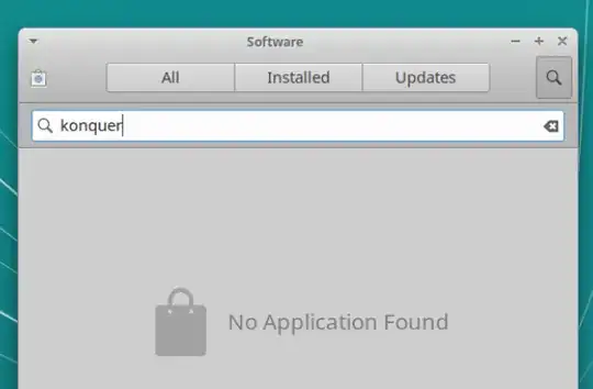

3: Unfortunately, even though Konqueror is available in the universe repository (and the universe repository is enabled on the desktop version of all Ubuntu flavors), gnome-software doesn't seem to find it, both on Xubuntu 18.04 and on Ubuntu 18.04:
Konqueror not found in Xubuntu 18.04
konqueror missing in Xubuntu
Konqueror not found in Ubuntu 18.04
konqueror missing in Ubuntu

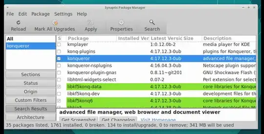

However, Synaptic Package Manager and the terminal route have no difficulty in finding and offering to install Konqueror.
Synaptic Package Manager finds Konqueror in Xubuntu
konqueror in spm

I usually will install synaptic and use that to do software searches. you can install it from a terminal by doing the following sudo apt update and then sudo apt install synaptic after it install launch synaptic and search for the software your looking for. There is also software center that has a search function it come pre installed on ubuntu flavors. If you installed xubuntu you do not have gnome software as such.
