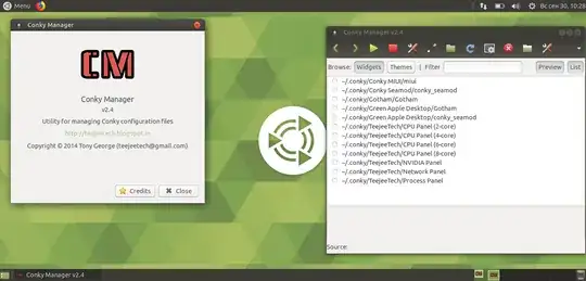

I ended with this one (ppa:mark-pcnetspec/conky-manager-pm9) as it has realpath package in PPA:
sudo add-apt-repository ppa:mark-pcnetspec/conky-manager-pm9
sudo apt-get install conky-manager
After installation you will get Conky Manager 2.4 running on your Ubuntu 18.04 LTS:
Conky Manager 2.4 on Ubuntu 18.04 LTS
