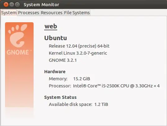

Apart from:
  • lsb_release -a and
  • cat /etc/*release ,
you can also see the version in the GNOME System Monitor (press Alt + F2, type gnome-system-monitor, and hit Enter):

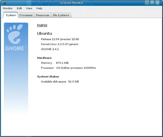

If you like a GUI more than the command line, the System page on System Monitor gnome-system-monitor application should give you more than enough information. Release name, architecture variant, cores in the system, RAM available, and the space available on the root file system.

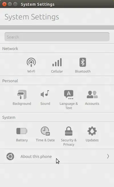

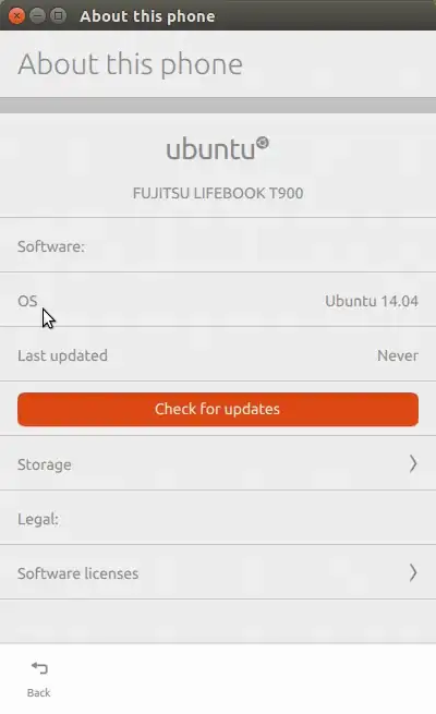

Ubuntu Touch
If you are using Ubuntu Touch or have the Ubuntu Touch version of System Settings installed, you can find out more about your version information by tapping/clicking the About this phone button near the bottom. The information displayed may vary depending on the device you are using.
Snapshot of button Snapshot of screen

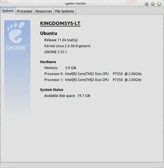

To find this information graphically, open the system monitor. The information you want is on the first tab: (NB: You cannot tell what stage of development it is at!) enter image description here
Also note mine is not saying "development branch", so the best way to tell what state your system was at when you installed it, is to know what you download :)!
