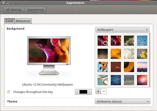

Changing Themes
Using the stock Appearance screen you can change the theme to the hard-coded themes.
If you want to use other GTK+ 3 (metacity) themes via a GUI you will need to use either MyUnity or gnome-tweak-tool Install gnome-tweak-tool.
How do I change to a theme not listed in the Appearance screen?
Alternatively - install the metacity theme and change the theme name using gconf-editor as described below.

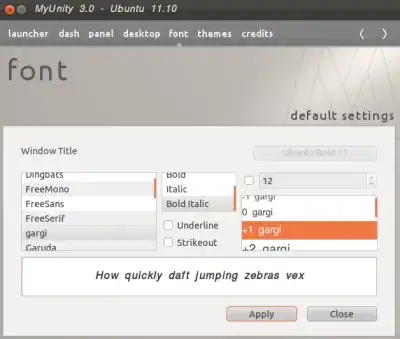

changing fonts
By using MyUnity (installation instructions in the above theme link*) you can change fonts using:

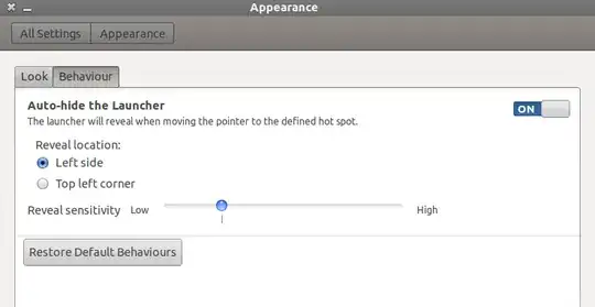

In 12.04 - the launcher is not hidden by default. You can set the autohide capability through the stock appearance screen.
From this tab you can configure where the launcher-hot spot is and thus how to invoke the launcher via the mouse.

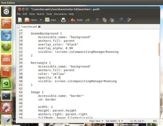

Altering the launcher colour and opacity requires editing the "Launcher.qml", however the file is located in different folders in Oneiric and Precise. If you are using oneiric: Hit ALT+F2 (or open a Terminal) and execute:
gksu gedit /usr/share/unity-2d/launcher/Launcher.qml
A text editor window will open with the file ready to edit. Navigate to section headed ‘rectangle‘ and change:
color: “#190318″
to
color: “$COLOUR”
where $COLOUR is whatever colour you like – fox example: pink оr green or #00ffcc.
If you are using Precise the Launcher.qml is located in /usr/share/unity-2d/shell/launcher so to edit it, you have to execute:
gksu gedit /usr/share/unity-2d/shell/launcher/Launcher.qml
Once it it you will have to navigate to chnage both "rectangle" and "Gnome Background" sections (Gnome Background) is just above rectangle. Here is a screenshot of a light yellow coloured launcher: enter image description here
