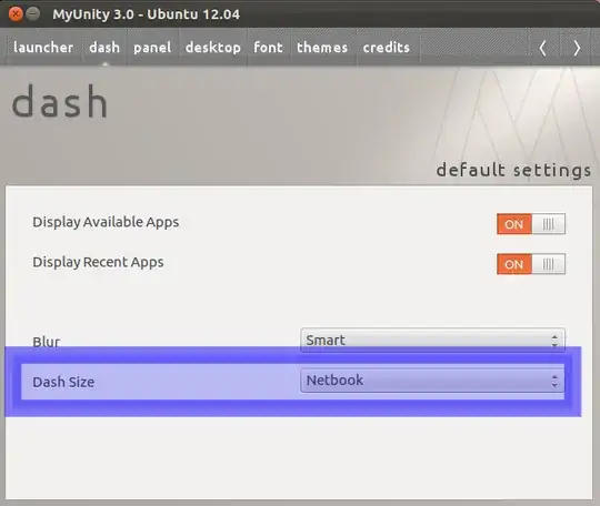

For 12.04 and later you can use MyUnity: Install MyUnity

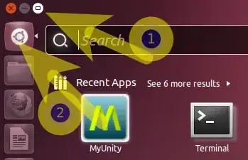

There is also a rather neat overlooked method...
Click the dash maximise button as shown, followed by the dash button itself. This changes from desktop to netbook and most importantly the setting is retained when you logout and login.
