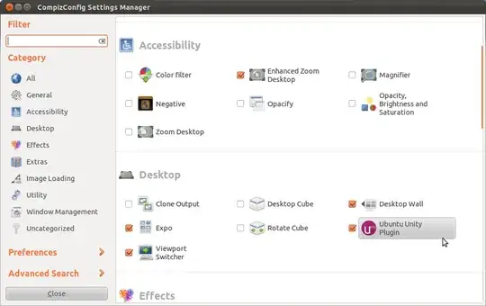

  • You first need to install the Compiz Config Settings Manager from the Ubuntu Software Center.
  • Second, open Compiz Config Settings Manager and go to Ubuntu Unity Plugin. There under the Experimental tab, adjust the bar corresponding to Launcher Icon Size to your need.
ccsm
ubuntu unity plugin - ccsm
