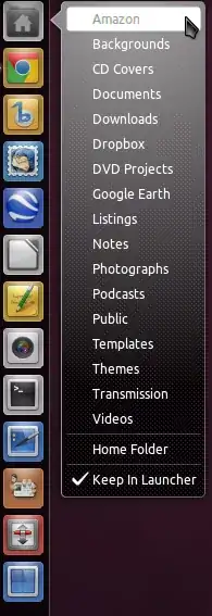

Home Icon Quicklist
Home Icon Quicklist
  1. Copy 'Home Folder' launcher file to your home directory:
    mkdir ~/.local/share/applications
    cp /usr/share/applications/nautilus-home.desktop ~/.local/share/applications
  2. Open the file for editing in gedit:
    gedit ~/.local/share/applications/nautilus-home.desktop
  3. Delete the following line from the file:
    OnlyShowIn=GNOME;
  4. Add this text to the bottom of the file, then close and save:
    X-Ayatana-Desktop-Shortcuts=Videos;Documents;Music;Pictures;Downloads
    [Videos Shortcut Group]
    Name=Videos
    Exec=nautilus Videos
    TargetEnvironment=Unity
    [Documents Shortcut Group]
    Name=Documents
    Exec=nautilus Documents
    [Music Shortcut Group]
    Name=Music
    Exec=nautilus Music
    [Pictures Shortcut Group]
    Name=Pictures
    Exec=nautilus Pictures
    [Downloads Shortcut Group]
    Name=Downloads
    Exec=nautilus Downloads
  5. Log out and log in again to see the changes.
Source

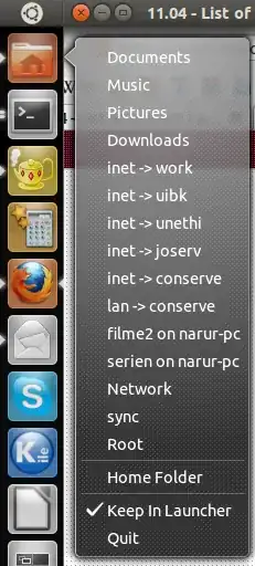

Home Icon Quicklist (auto-update from bookmarks)
Here is a small shell script that updates your Home-Quicklist with all your bookmarks. No manual manipulation. It reads your bookmark file and creates the menu items from it. It also adds the "Root Filemanager" menu entry.
Screenshot of the quicklist in action
  1. Copy the script listed below into an empty file and put it in your scripts-folder (we will assume that is ~/bin/ and the script name you choose is unityhome.bash).
  2. Run the script once to add the entries:
    bash ~/bin/unityhome.bash
  3. Optionally you may have cron run the script for you every once in a while. To add it to cron, type the follwing command into a shell:
    crontab -e
    An editor will open. There add a line like:
    @reboot /bin/bash/ $HOME/bin/unityhome.bash > /dev/null 2>&1
    If you don't do this step, you'll have to run the script by hand every time you change your nautilus bookmarks if you want the quicklist updated.
  4. Changes only take effect on your next login or after you Alt+F2
    unity --replace
    So do that. Note: Don't run unity --replace in a terminal. If you close that terminal, it will kill unity with it.
  5. Enjoy and have a look at the similar script for gnome-terminal that parses your ssh bookmarks (in ~/.ssh/config).
Script:
Here is the script:
#!/bin/bash
# tabsize: 4, encoding: utf8
# © 2011 con-f-use@gmx.net. Use permitted under MIT license:
#     http://www.opensource.org/licenses/mit-license.php
# CONTRIBUTORS: Chris Druif <cyber.druif@gmail.com>
#               Scott Severance <http://www.scottseverance.us/>
#               jacopoL <jacopo.jl@gmail.com>
# This script updates the unity quicklist menu for nautilus to contain the user
# bookmarks. The updates will have efect after unity is restarted (either on
# the next login or by invoking 'unity --replace').
# location of template and unity bar launchers
nautempl="/usr/share/applications/nautilus-home.desktop"
target="$HOME/.local/share/applications/nautilus-home.desktop"
bookmarks="$HOME/.gtk-bookmarks"
# backup if file already exists
if [ -e "$target" ]; then
    echo "Creating backup of: $target."
    mv -n "$target" "$target.bak"
fi
# copy template
cp "$nautempl" "$target"
if ! grep -q 'OnlyShowIn=.*Unity' "$target"; then # add only if not already present
    sed -i "s/\(OnlyShowIn=.*\)/\1Unity;/" "$target"
fi
# due to a bug in Unity (Ubuntu 11.10+) we will have to completely remove the OnlyShowIn line:
# https://bugs.launchpad.net/ubuntu/+source/unity/+bug/842257/comments/6
sed -i '/^OnlyShowIn=/d' "$target"
if ! grep -q 'X-Ayatana-Desktop-Shortcuts=' "$target"; then # add only if not already present
    echo -e "\nX-Ayatana-Desktop-Shortcuts=\n" >> "$target"
else
    echo >> "$target"
fi
bmcount=0
while read bmline; do
    bmcount=$(($bmcount+1))     # number of current bookmark
    bmname=${bmline#*\ }        # name of the bookmark
    bmpath=${bmline%%\ *}       # path the bookmark leads to
    # deal with bookmarks that have no name
    if [ "$bmname" = "$bmpath" ]; then
        bmname=${bmpath##*/}
    fi
    # fix spaces in names and paths
    bmname="$(echo "$bmname" | sed 's/%20/ /g')"
    bmpath="$(echo "$bmpath" | sed 's/%20/ /g')"
    # fix accents in names and paths (for french users)
    bmname="$(echo "$bmname" | python -c 'import sys,urllib;sys.stdout.write(urllib.unquote(sys.stdin.read()))')"
    bmpath="$(echo "$bmpath" | python -c 'import sys,urllib;sys.stdout.write(urllib.unquote(sys.stdin.read()))')"
    # extend shortcut list with current bookmark, prepending a ; if needed
    sed -i "s/\(X-Ayatana-Desktop-Shortcuts=\(.*;$\|$\)\)/\1Scg${bmcount};/
            t
            s/\(X-Ayatana-Desktop-Shortcuts=.*\)/\1;Scg${bmcount};/" "$target"
    # write bookmark information
    cat - >> "$target" <<EOF
[Scg$bmcount Shortcut Group]
Name=$bmname
Exec=nautilus "$bmpath"
EOF
done < "$bookmarks"
# Add a root file manager entry
sed -i "s/\(X-Ayatana-Desktop-Shortcuts=.*\)/\1RootFM;/" "$target"
[RootFM Shortcut Group]
Name=Root
Exec=gksudo nautilus
EOF
exit 0
Improvement: Do not duplicate "Home folder" and "username"
If you don't want to have two items targeting your Home folder ("Home Folder" at the bottom of the quicklist and the clickable username), you can replace the following code:
Name=$bmname
EOF
done < "$bookmarks"
by the following code:
    if [ "file://$HOME" != "$bmpath" ]; then
Name=$bmname
EOF
    fi
done < "$bookmarks"

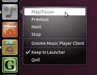

    [Next Shortcut Group]
    Name=Next
    Exec=rhythmbox-client --next
    [Stop Shortcut Group]
    Name=Stop
    Exec=rhythmbox-client --stop
  4. Save the file.

Extended Home Icon Quicklist
Quick Lists
  1. Copy 'Home Folder' launcher file to your home directory with Terminal:
    OnlyShowIn=GNOME;
    X-Ayatana-Desktop-Shortcuts=Amazon;Backgrounds;CD Covers;Documents;Downloads;Dropbox;DVD Projects;Google Earth;Listings;Music;Notes;Photographs;Podcasts;Public;Templates;Themes;Transmission;Videos
    [Amazon Shortcut Group] Name=Amazon Exec=nautilus Amazon TargetEnvironment=Unity
    [Backgrounds Shortcut Group] Name=Backgrounds Exec=nautilus Backgrounds TargetEnvironment=Unity
    [CD Covers Shortcut Group] Name=CD Covers Exec=nautilus CDCovers TargetEnvironment=Unity
    [Documents Shortcut Group] Name=Documents Exec=nautilus Documents TargetEnvironment=Unity
    [Dropbox Shortcut Group] Name=Dropbox Exec=nautilus Dropbox TargetEnvironment=Unity
    [Downloads Shortcut Group] Name=Downloads Exec=nautilus Downloads
    [DVD Projects Shortcut Group] Name=DVD Projects Exec=nautilus DVDProjects TargetEnvironment=Unity
    [Google Earth Shortcut Group] Name=Google Earth Exec=nautilus GoogleEarth TargetEnvironment=Unity
    [Listings Shortcut Group] Name=Listings Exec=nautilus Listings TargetEnvironment=Unity
    [Notes Shortcut Group] Name=Notes Exec=nautilus Notes TargetEnvironment=Unity
    [Photographs Shortcut Group] Name=Photographs Exec=nautilus Photographs TargetEnvironment=Unity
    [Podcasts Shortcut Group] Name=Podcasts Exec=nautilus Podcasts TargetEnvironment=Unity
    [Public Shortcut Group] Name=Public Exec=nautilus Public TargetEnvironment=Unity
    [Templates Shortcut Group] Name=Templates Exec=nautilus Templates TargetEnvironment=Unity
    [Themes Shortcut Group] Name=Themes Exec=nautilus Themes TargetEnvironment=Unity
    [Transmission Shortcut Group] Name=Transmission Exec=nautilus Transmission TargetEnvironment=Unity
    [Videos Shortcut Group] Name=Videos Exec=nautilus Videos TargetEnvironment=Unity

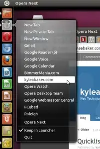

Opera Launcher & Quicklist (Part 2)
  • Tab counter
    The total number of tabs you have open appears on the Launcher icon and is updated in real time as you open and close tabs;
  • Urgency
    When Opera is not in focus and a new tab is opened, the Opera icon in the Launcher now enters urgency mode and wiggles once;
  • Quicklist
    With (at the moment) limited support for Opera’s built in Mail client (M2).
    Quicklist Urgency Tab count
Installation
  1. Extract the script from this zip into your home folder.
  2. Open Startup Applications and add an entry using the above script as follows:
    Command: python unity-opera.py
    startup
Source
Kudos go to Kyle Baker!

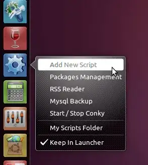

Custom Scripts Quicklist with GUI
Create Quicklist launcher for your scripts. Embedded GUI with automatic and manual option for adding entries. The automatic option can only add, with the manual you can modify the file directly.
1. Create custom .desktop file for launcher
gedit ~/.local/share/applications/my_scripts.desktop
2. Paste the following code and edit following:(line 5 is the way to folder with your scripts, in this example, this is folder with the name Scripts, you need to change it for your location. You can change also the line 6 which is an icon. And at the end change <username> text to match your home folder username.
[Desktop Entry]
Name=My Scripts Folder
Comment=Open your scripts folder
TryExec=nautilus
Exec=xdg-open /home/<username>/Scripts
Icon=ibus-engine
Terminal=false
StartupNotify=true
Type=Application
Categories=GNOME;GTK;Core;
OnlyShowIn=GNOME;Unity;
X-GNOME-Bugzilla-Bugzilla=GNOME
X-GNOME-Bugzilla-Product=nautilus
X-GNOME-Bugzilla-Component=general
X-Ubuntu-Gettext-Domain=nautilus
X-Ayatana-Desktop-Shortcuts=AddScript
[AddScript Shortcut Group]
Name=Add New Script
Exec=/home/<username>/.local/share/applications/scripts/addscript
3. Create a 'scripts' folder (if not exist) in ~/.local/share/applications folder:
mkdir ~/.local/share/applications/scripts
4. Create the script file 'addscript' with gedit (this is the GUI for adding entries to your quicklist):
gedit ~/.local/share/applications/scripts/addscript
5. Add this text to the file,then save and close
#!/bin/bash
menuitem=`zenity --list --title="My Scripts Launcher Manager" \
--width=300 --height=150 \
--text="Select action" \
--column="Pick" --column="Action" \
--radiolist TRUE Add-Script-Automatically FALSE Add/Edit/Delete-Manually`
case $menuitem in
Add-Script-Automatically )
hkey=$(zenity --entry --text "Set  name for your script" --entry-text "" --title "Set name")
if [ -z "$hkey" ]; then
zenity --error --title "Set  name for your script "   --text="The script name is empty. Exiting ..."
exit 0
fi
ay=$(sed -n '/X-Ayatana-Desktop-Shortcuts/p' /$HOME/.local/share/applications/my_scripts.desktop)
shortname2=$(echo "$hkey" | sed 's/\///g')
shortname=$(echo "$shortname2" | sed 's/ /_/g')
hkey3=$(zenity --entry --text "Set command for your script" --entry-text "" --title "Set command")
if [ -z "$hkey3" ]; then
zenity --error --title "Set command "   --text="The command is empty. Exiting ..."
exit 0
fi
sed -i "s/$ay/$ay;$shortname/g" /$HOME/.local/share/applications/my_scripts.desktop
echo "" >>  /$HOME/.local/share/applications/my_scripts.desktop
echo "[$shortname Shortcut Group]" >>  /$HOME/.local/share/applications/my_scripts.desktop
echo "Name=$hkey" >>  /$HOME/.local/share/applications/my_scripts.desktop
echo "Exec=$hkey3" >>  /$HOME/.local/share/applications/my_scripts.desktop
echo "TargetEnvironment=Unity" >> /$HOME/.local/share/applications/my_scripts.desktop
zenity --info --title "New entry added" --text "Changes only take effect on next login"
Add/Edit/Delete-Manually)
zenity --text-info --filename=/$HOME/.local/share/applications/my_scripts.desktop > /tmp/my_scripts.desktop.edited  --title "Add/Edit/Delete Script"  --editable --width 850 --height 480
cp /tmp/my_scripts.desktop.edited /$HOME/.local/share/applications/my_scripts.desktop
rm /tmp/my_scripts.desktop.edited
esac
6. Make the file executable:
chmod +x ~/.local/share/applications/scripts/addscript
7.Drag & Drop the my_scripts.desktop file from ~/.local/share/applications in nautilus to the Unity Launcher Bar
8. You can start adding entries to your quicklist with clicking on "Add New Script" menu item

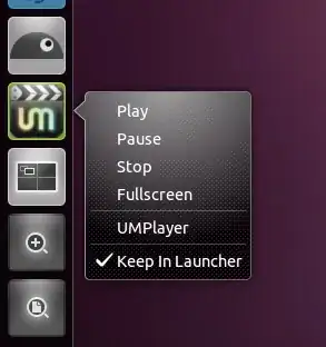

UMPlayer Quicklist
  • Copy the original .desktop file to your home folder:
    cp /usr/share/applications/umplayer.desktop ~/.local/share/applications/
  • Open that desktop file for editing :
    gedit ~/.local/share/applications/umplayer.desktop
  • Add the following at the bottom of the file.
     X-Ayatana-Desktop-Shortcuts=Play;Pause;Stop;Fullscreen;
     [Play Shortcut Group]
     Name=Play
     Exec=umplayer -send-action play
     [Pause Shortcut Group]
     Name=Pause
     Exec=umplayer -send-action pause
     Name=Stop
     Exec=umplayer -send-action stop
     [Fullscreen Shortcut Group]
     Name=Fullscreen
     Exec=umplayer -send-action fullscreen
  • Save it and navigate to ~/.local/share/applications/ and then drag it to the launcher .

Quicklist for Music Player Daemon (MPD) clients
Screenshot
Adds play/pause, previous, next and stop to the launcher of an MPD client (in this case GMPC, but this can easily be adapted for e.g. xfmpc, Sonata, Ario, Pygmy, pympd, Glurp, Gimmix, gbemol or whatever you fancy). The only requirement is that you install the package mpc (sudo apt-get install mpc).
  1. Copy the global gmpc.desktop file to your home directory:
    cp /usr/share/applications/gmpc.desktop ~/.local/share/applications
  2. Edit the file:
    gedit ~/.local/share/applications/gmpc.desktop
  3. Paste the following code to the bottom of the file:
    X-Ayatana-Desktop-Shortcuts=Play/Pause;Previous;Next;Stop
    [Play/Pause Shortcut Group]
    Name=Play/Pause
    Exec=mpc toggle
    [Previous Shortcut Group]
    Name=Previous
    Exec=mpc prev
    Name=Next
    Exec=mpc next
    Name=Stop
    Exec=mpc stop
PS. For extra integration, install mpd-sound-menu.

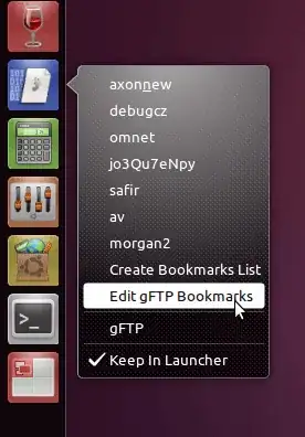

gFTP Quicklist
h
Access directly the bookmarked sites with gFtp. In Launcher is included the script for Bookmarks List generating
  1. Copy the global gftp.desktop file to your home directory:
    cp /usr/share/applications/gftp.desktop ~/.local/share/applications
  2. Open the file for editing with gedit:
    gedit ~/.local/share/applications/gftp.desktop
  3. Paste the following code to the bottom of the file change only the <username> to yours:
    X-Ayatana-Desktop-Shortcuts=GenerateB;EditB
    [GenerateB Shortcut Group]
    Name=Create Bookmarks List
    Exec=/home/<username>/.local/share/applications/scripts/addbookmarks generateb
    [EditB Shortcut Group]
    Name=Edit gFTP Bookmarks
    Exec=/home/<username>/.local/share/applications/scripts/addbookmarks editb

    chmod +x ~/.local/share/applications/scripts/addbookmarks
  8. Drag & Drop the gftp.desktop file from ~/.local/share/applications in nautilus to the Unity Launcher Bar
  9. FIRST RUN !!
    Click on the "Edit gFTP Bookmarks" menu item and edit your gftp bookmarks file. By default file contains a lot of ftp sites which are not used. Remove unused bookmarks and close the file. Next, click on the "Create Bookmark List" and your list is generated.
    List editing is with the same way, at first edit the bookmarks list, next generate the new one.

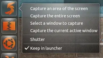

Shutter:
There is a quick list by default for shutter (a program to take screen-shots and edit them) when you install it Ubuntu unity.
shutter quick-list
Download shutter(ppa & .dep) : here
Tip: This programs must be opened(or found in startup menu) to see it's quick-list

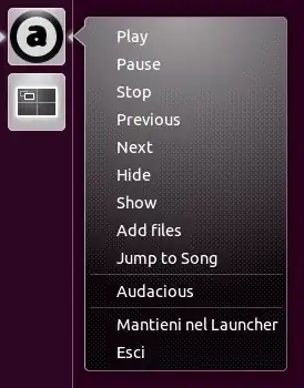

Audacious Quicklist
Audacious Quicklist
Quicklist for Audacious that allows controlling playback (redundant if using Audacious 3.2+, because you can control it from the Sound Menu), showing and hiding the main window (you can also unhide it by selecting Audacious from the Sound Menu), adding files to the current playlist and jumping to another song in the playlist.
  1. Copy the original launcher file to your home folder:
     mkdir -p ~/.local/share/applications
     cp /usr/share/applications/audacious2.desktop ~/.local/share/applications/
  2. Open that file for editing:
     gedit ~/.local/share/applications/audacious2.desktop
  3. Add the following at the bottom of the file, then close and save.
     X-Ayatana-Desktop-Shortcuts=Play;Pause;Stop;Rew;Fwd;Hide;Show;AddFiles;Jump
     Name=Play
     Exec=audacious -p
     Name=Pause
     Exec=audacious -u
     Name=Stop
     Exec=audacious -s
     [Rew Shortcut Group]
     Name=Previous
     Exec=audacious -r
     [Fwd Shortcut Group]
     Name=Next
     Exec=audacious -f
     [Hide Shortcut Group]
     Name=Hide
     Exec=audtool mainwin-show off
     [Show Shortcut Group]
     Name=Show
     Exec=audtool mainwin-show on
     [AddFiles Shortcut Group]
     Name=Add files
     Exec=audtool filebrowser-show
     [Jump Shortcut Group]
     Name=Jump to Song
     Exec=audacious -j
  4. Log out and log in again to see the changes.
