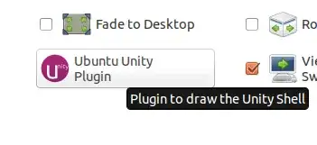

First install the CCSM (Compiz Config Settings Manager) if you have not yet done so:
sudo apt-get install compizconfig-settings-manager`
In Dash, type cc which should show the Compiz Config Settings Manager app. Open it and go to the Unity plugin:

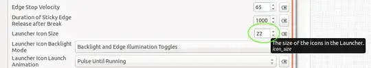

Select the Launcher tab:
Change the value in the Launcher Icon Size option:
You can change it from 8 to 64. The only deal is, if you right click the Desktop and select Change Desktop Background, the value for the icons found there will be the one applied. Right now, both, the CCSM Icon size and the Desktop Icon size or not using the same variable for this.

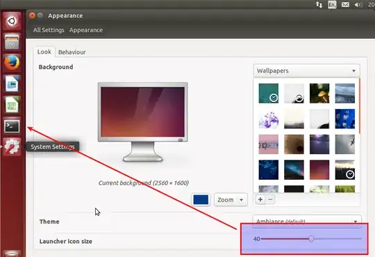

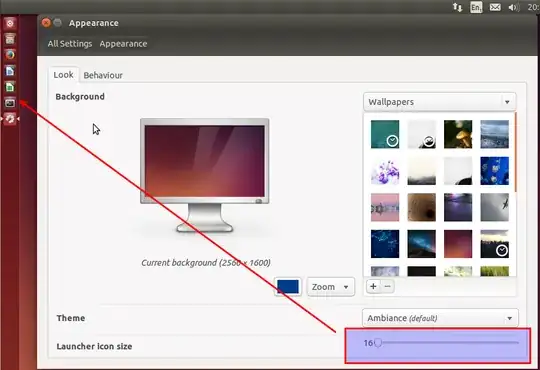

14.04
From 14.04 the launcher icon size can be reduced below 32 pixels in size - all the way down to 16 pixels.
Pictures paint a thousand words:
Standard size:
Smallest size:
