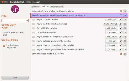

For 11.10:
This isn't currently possible, however there is a workaround that you can set that will display the applications in your current workspace first, which means you can Alt-Tab to it quickly without having to go through applications in your other workspaces. Though this doesn't limit the switcher to the current desktop but it at least puts the apps on that desktop first:
First:
  1. Install the CompizConfig Settings Manager (CCSM).
  2. Then go to the Switcher tab and select "Bias alt-tab sorting ...." and make sure you check the box.
