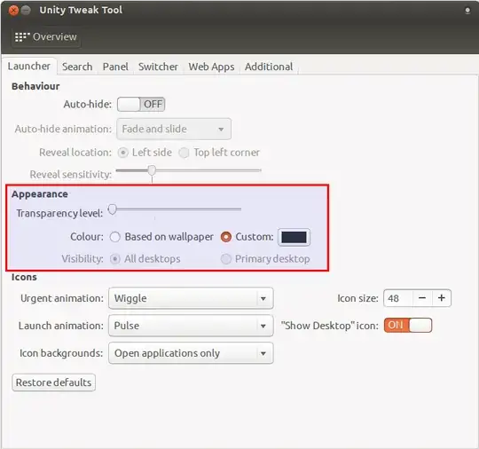

In 13.10,
  • Install unity tweak tool.
  • change launcher background setting.
  • select dark custom color for background.
dash window background also would be affected by that setting.
unity tweak tool launcher setting
