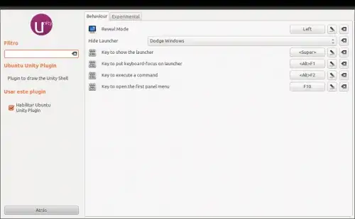

The launcher appears to slow and disappears to fast how can I disable autohiding behavior of launcher. I use desktop pc
vrcmr
  • 6,397
First of all, install the Compizconfig settings manager from Ubuntu Software Center or just run following command: sudo apt-get install compizconfig-settings-manager Start it under System -> Preferences menu, find “Ubuntu Unity Plugin” and click into its configuration page.
Then change AutoHide Launcher to: Never
