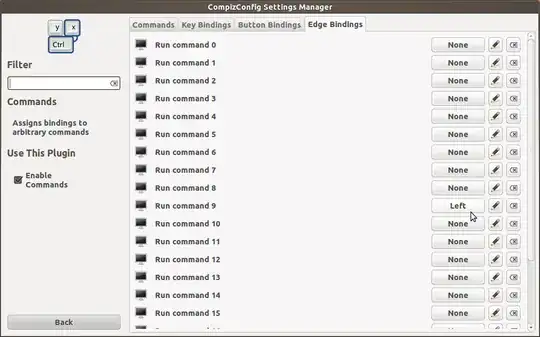

  1. We will need XDoTool and Compiz.
    You can install these from the Ubuntu Software Center or by clicking xdotool Install xdotool and Compiz Install Compiz.
  2. Open Compiz (Alt + F2, type ccsm and hit Enter).
  3. Go to Commands and add xdotool key super to one command.
    screenshot showing xdotool key super added as command 9
  4. Then go to Edge Bindings and choose “Left” for that command.
    screenshot showing that Left is selected for command 9

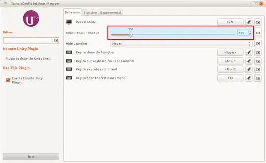

For 11.10 (Oneiric):
In Ubuntu 11.10 it is now possible to change the edge reveal time out using compizconfig-settings-manager Install compizconfig-settings-manager.
To open it press Alt+F2,paste about:config and hit enter.*
Then change the Edge Reveal Timeout in the Behaviour/Behavior tab.
ccsm
* (You can also run ccsm from a launcher such as synapse or from the terminal).

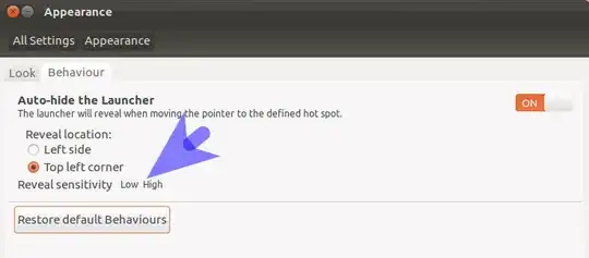

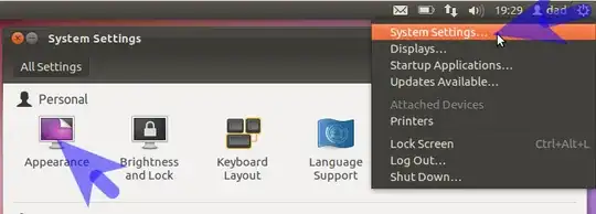

12.04 & Unity
The Unity Launcher delay is now a System Setting - Appearance option:
From the Behaviour tab you have the option to switch-on autohiding of the Launcher and using the slidebar to control the responsiveness to the reveal of the launcher.
The higher the sensitivity the quicker the launcher will reveal.
12.04 & Unity-2D
The Unity-2D Launcher delay is now a System Setting - Appearance option:
From the Behaviour tab you have the option to switch-on autohiding of the Launcher and by clicking the Low/High buttons to control the responsiveness to the reveal of the launcher.

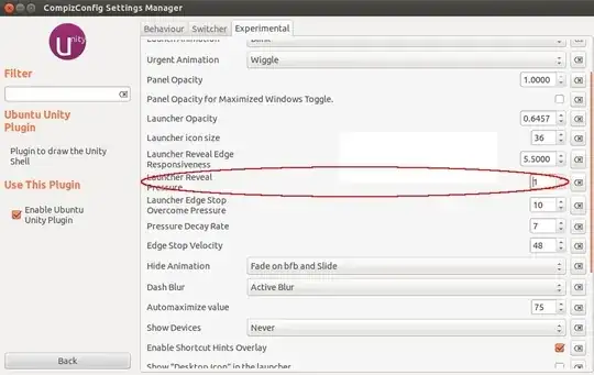

This is how it works. There is experimental tab in Unity Compiz plugin. Check with the values in the screenshot. And change the launcher reveal pressure. Optimal value for this is 7. A value of 1 will make the launcher popup faster but it may interrupt our actions.screenshot
