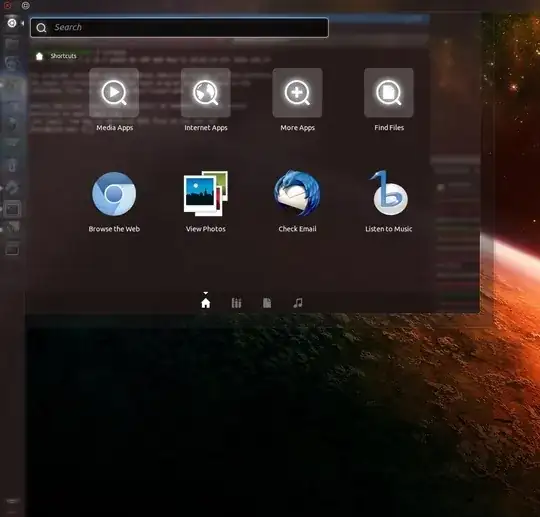

I really dislike the slight dark-purple tint to the side-launcher bar and shell surrounding the menu after pressing the meta key. How can I set this to another color?
There are configure options available for Unity here but there is no option for this, so I am looking for pointers in the code where this can be set.
