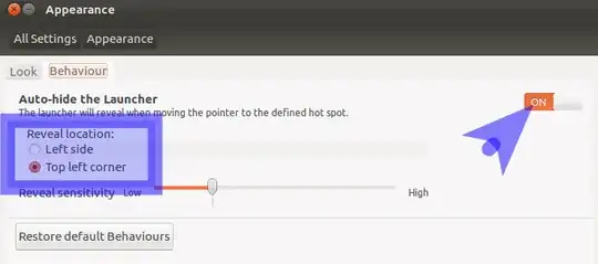

12.04 and later - Unity
The Unity Launcher auto-hide option is now a System Setting - Appearance option: By default, auto-hide is switched off - in previous versions of Ubuntu these behaviour was reverse.
From the Behaviour tab you have the option to switch-on autohiding of the Launcher and using the slide-bar to control the responsiveness to the reveal of the launcher.
You can use the Reveal Location radio-buttons to indicate where you need to position your mouse to reveal the launcher.
The option to switch on autohiding and controlling the hotspot location (left edge/top left corner) is on the Behaviour tab.
Unlike previous versions of Ubuntu, the dodge windows option has been removed due to User testing that showed that this form of autohiding caused confusion.

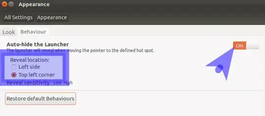

12.04 & Unity-2D
The Unity-2D Launcher delay is now a System Setting - Appearance option:
From the Behaviour tab you have the option to switch-on autohiding of the Launcher and by clicking the Low/High buttons to control the responsiveness to the reveal of the launcher.
By default the auto-hide nature is toggled off meaning the launcher is permanently visible.

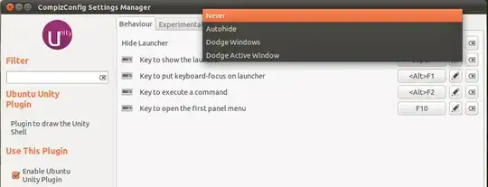

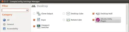

11.04 & 11.10
You can disable the autohide feature of the Unity launcher by following these simple steps:
WARNING: CCSM is an advanced tool and using it may break your Unity. To avoid this, follow the steps exactly as mentioned here
  • Install the CompizConfig Settings Manager package via the Ubuntu Software Centre
Installing the Compiz settings manager
  • Once installed, open the settings manager and scroll down until you see the 'Ubuntu Unity Plugin' which is located in the Desktop category.
The Compiz settings manager
  • Set 'Hide Launcher' to 'Never'.
Changing the Launcher autohide settings
  • The settings will have automatically applied and the launcher will now be locked in place.

With Compiz Config (ccsm) installed, go to the Ubuntu Unity Plugin, now you will see a drop-down menu next to the words Hide Launcher, click on the drop down menu and select Never and that is it, Unity launcher will no longer hide.

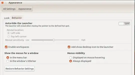

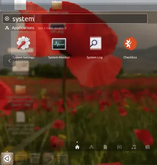

You can auto-hide the Unity Launcher. Follow the below steps to do so.
  • First open the System Setting. system setting
  • Now Click on Appearance icon in Personal group.
  • Now a window similar to below one can be seen. appearance window
  • You can see that the auto-hide feature is turned OFF by default in my version(16.04).
  • You are there! Click on the toggle switch to turned the feature ON.
You can see that Unity-Launcher auto-hides when cursor is off from it.
You can do the same in Ubuntu versions above 12.04

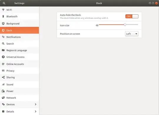

17.10
In Ubuntu 17.10, open Settings (can press windows/super key and search for settings) and then toggle the Auto-hide the Dock option under Dock.
Dock Settings
