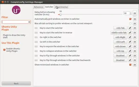

I found this patch suggested in a launchpad discussion about this issue, and I've compiled it. Now I can configure the timeout (it's the "Delay before showing switcher" option at the top). I've uploaded the compiled deb files (for Oneiric 64 bit) on 4shared and in a torrent, if anyone wants it.
