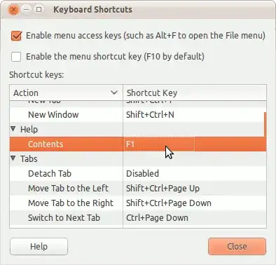

  1. In a gnome-terminal open up Edit ➜ Keyboard Shortcuts.
  2. Scroll down to the Help/Contents shortcut, click where it says "F1" and hit Backspace:

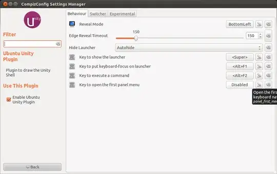

  1. Install the compizconfig-settings-managerInstall compizconfig-settings-manager package.
  2. Open up CompizConfig Settings Manager.
    • Hit Super to open the Dash, type "Compiz" and hit Enter.
  3. Type "unity" in the Filter entry and select the Ubuntu Unity Plugin.
  4. Click the button to the right of Key to open the first panel menu and uncheck the Enabled checkbox.

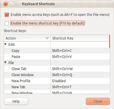

  5. That disabled the global F10 shortcut, now disable gnome-terminal's F10 shortcut:
    • In a gnome-terminal open up Keyboards Shortcuts (Edit ➜ Keyboard Shortcuts) and
      uncheck Enable the menu shortcut key (F10 by default)

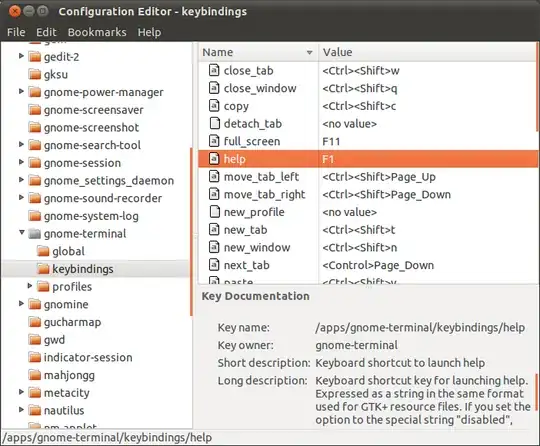

start gconf-editor and follow /apps/gnome-terminal/keybindings/help
Description:
"Keyboard shortcut key for launching help. Expressed as a string in the same format used for GTK+ resource files. If you set the option to the special string "disabled", then there will be no keyboard shortcut for this action."

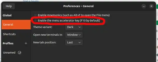

Ubuntu 22.04 - Disable F10 in GNOME Terminal
  1. Disable it with a command:
    gsettings set org.gnome.Terminal.Legacy.Settings menu-accelerator-enabled false
  2. Disable if from Settings:
    Open GNOME Terminal → Settings (the hamburger button) → PreferencesGeneral and uncheck Enable the menu accelerator key (F10 by default).
    GNOME Terminal Preferences menu

For exiting mc (with F10 key). Disable "Key to open the first panel menu" in unity compiz plugin (ccsm)

@kholis is correct for disabling F10 in Unity, but if you're a newb like me, you need a little more information to make this work.
If not already installed, install compizconfig-settings-manager:
sudo apt-get install compizconfig-settings-manager
Start the newly installed settings manager, and filter for "unity"
Edit "Key to open the first panel menu" to disable it or change it to another key.
I have not yet found a way to change F1.

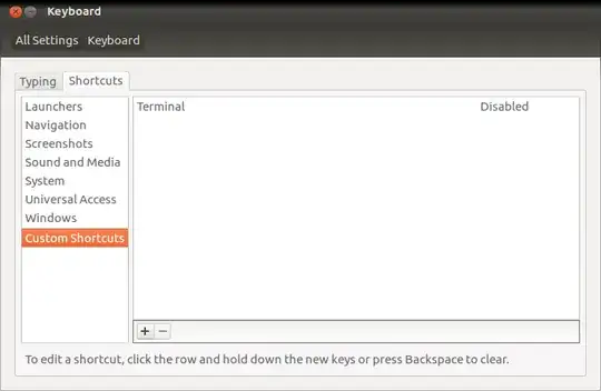

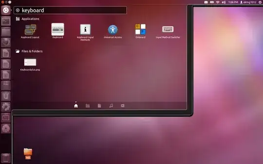

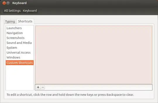

Mapping hot-keys in 12.04 is simply accomplished through the Keyboard widget.
In the Unity launcher find keyboard.
select keyboard
In the window that opens select the shortcuts tab and custom shortcuts.
Click the plus to add a new shortcut.
plus
Name it to whatever matches the functionality you're assigning it.
Enter the command you want it to run in command.
apply
At the right side of the window click where it says disabled. This should toggle to New Accelerator.
disabled
Now just hit F10.
The Custom Shortcuts accelerator you defined overrides the Right-click simulation behavior. You could set this the command to echo 'nope' > /dev/null if you just want your F10 to do nothing.
