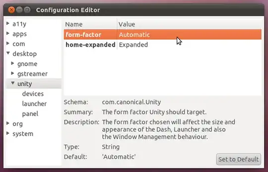

Alternatively, you can install the configuration editor dconf-editor from the package dconf-tools and do the same the graphical way:

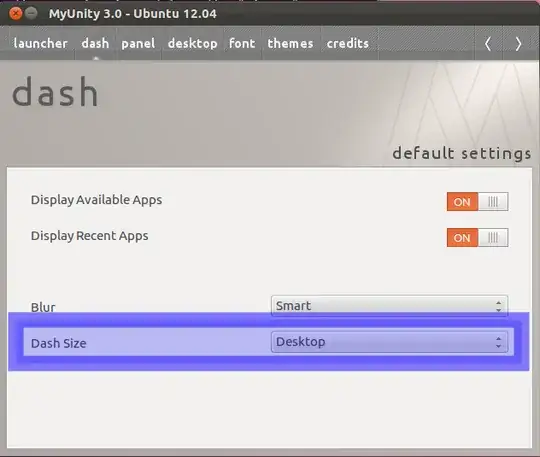

For 12.04 and later you can use MyUnity Install MyUnity:

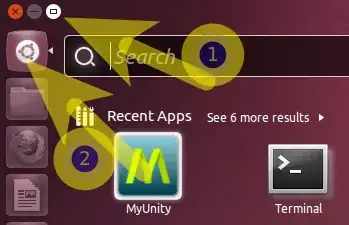

There is also a rather neat overlooked method...
Click the dash maximise button as shown, followed by the dash button itself. This changes from netbook to desktop and most importantly the setting is retained when you logout and login.

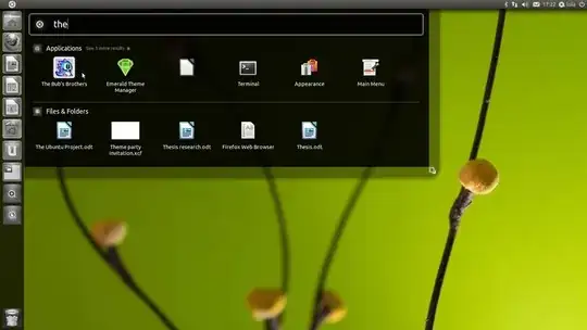

When 11.10 comes out you will be able to make it smaller by pressing the minimize button, in the left corner. And if you want to maximize it again, do so by pressing the maximize button.
