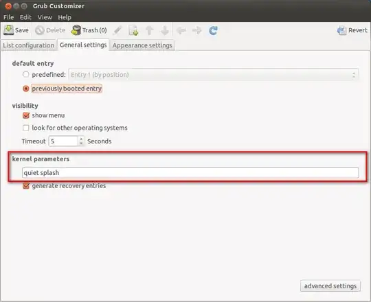

Alternatively, you may also use the handy grub-customizer:
sudo add-apt-repository ppa:danielrichter2007/grub-customizer
sudo apt-get update
sudo apt-get install grub-customizer
gksu grub-customizer &
Just open a boot entry, and edit its kernel parameters as highlighted in the screenshot below:
screenshot
