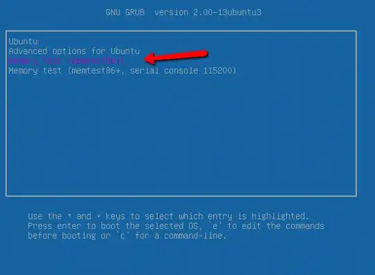

The Ubuntu Live CD includes a tool called Memtest86+ that will do just that—test your computer’s RAM. Boot up from the Ubuntu LiveCD, press and hold the Shift key, which will bring up the GRUB menu. Select Memory Test

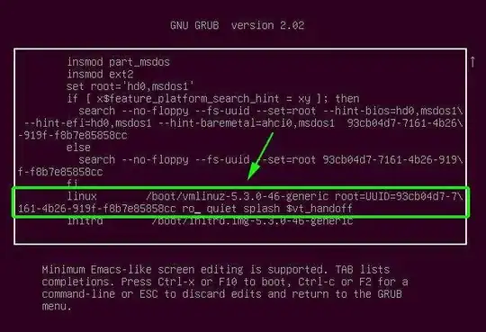

No need for Memtest86+ (since v2.6.27, 2008-10-09):
  1. Reboot your computer: reboot.
  2. At the GRUB boot screen (with UEFI, press Esc).
  3. For 4 passes add temporarily the memtest=4 kernel parameter.
    memtest=        [KNL,X86,ARM,PPC,RISCV] Enable memtest
                    Format: <integer>
                    default : 0 <disable>
                    Specifies the number of memtest passes to be
                    performed. Each pass selects another test
                    pattern from a given set of patterns. Memtest
                    fills the memory with this pattern, validates
                    memory contents and reserves bad memory
                    regions that are detected.
    screenshot

Reboot your computer, and at the GRUB boot screen, select memtest.
