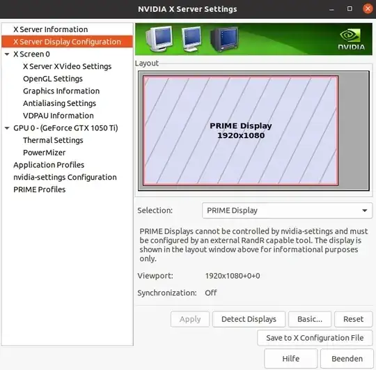

Trying to edit the Nvidia X Server Settings does not help because the look like this:
This was the reason why I tried the other solution described here which worked for me.

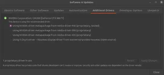

I was able to solve the problem by selecting the most recent driver 440 (the following picture is from this source; that is why there is a different GeForce GTX model displayed):
Then, I edited the .conf file by replacing options nvidia_435_drm modeset=1 with options nvidia_440_drm modeset=1 and restarted the computer.
