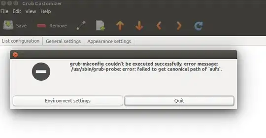

EDIT :- I tried these two seperate method also and they have issue of there own. LINK - link
  1. Boot repair - It just doest open.
    2.grub-crustomizer - NOte- I also added device.map manually but what to do with grub.cfg now.
I want to add boot parameter(pci=nomsi) permanently by which ever method works. Thanks,
So after trying sudo nano /etc/default/grub. I see this after every fresh boot.enter image description here
Despite that, effects of pci=nomsi are not taking place and system is not booted with that parameter. How do i know that? Because when i type this command- cat /proc/cmdline
there is no (pci=nomis) at the end of quite splash. Pic - enter image description here
