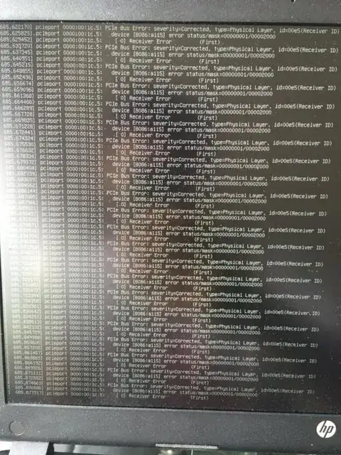

I have a new HP Pavilion Gaming Notebook and a new installation of Ubuntu 16.04. When I press Ctrl + Alt + F1 I go start seeing the errors shown in the following image and it doesn't allow me to interact with the console:
I also see these errors for a while everytime I boot. I need to do Ctrl + Alt + F1 to access a non graphical terminal to install some Nvidia drivers. What's going on?
What's causing the problem seems to be: 00:1c.5 PCI bridge [0604]: Intel Corporation Sunrise Point-H PCI Express Root Port #6 [8086:a115] (rev f1)

Try this,
Use this link ( about the adding paramter to kernel here) to understand about adding kernel boot paramter temporarily and making it permanent. Then,
Add the parameter , pci=nomsi
And reboot.
If the problem is solved then make the change permanent. If does not work then try,
pci=noaer
same way and make it permanent if this works.
(*Reason for appearance is related to the recent Intel Skylake architecture CPUs and Realtek rtl8723be wireless adaptor.
The ubuntu team knows about it. Read more here Bug_track_ubuntu_PCIe bus error )

Here already answers are provided which also helped me a lot. I use text mode of ubuntu 16.04 and so
GRUB_CMDLINE_LINUX_DEFAULT="quiet splash pci=nomsi"
didn't helped me. Here what I changed was -- (in /etc/default/grub)
GRUB_DISTRIBUTOR=`lsb_release -i -s 2> /dev/null || echo Debian`
#GRUB_CMDLINE_LINUX_DEFAULT="quiet splash pci=nomsi"
GRUB_CMDLINE_LINUX="text pci=nomsi"
# Uncomment to enable BadRAM filtering, modify to suit your needs
# This works with Linux (no patch required) and with any kernel that obtains
# the memory map information from GRUB (GNU Mach, kernel of FreeBSD ...)
#GRUB_BADRAM="0x01234567,0xfefefefe,0x89abcdef,0xefefefef"
# Uncomment to disable graphical terminal (grub-pc only)
GRUB_TERMINAL=console
# The resolution used on graphical terminal
# note that you can use only modes which your graphic card supports via VBE
# you can see them in real GRUB with the command `vbeinfo'
#GRUB_GFXMODE=640x480
which solved my error(NOTE - I used only pci=nomsi, and in case it don't work other option is pci=noaer), that may help solve anyone facing the same error.
