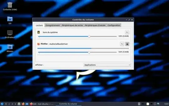

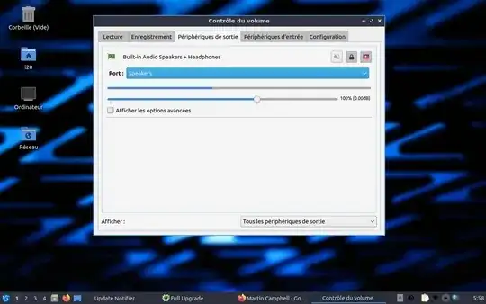

Hi I have an acer aspire switch 10e (which is a notebook) and lubuntu 21.04 is running on it. I have no sound even though my hard ware seems to be recognised:
These are screenshots from pulseaudio gui settings.

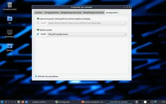

Configuration: enter image description here Ouput devices: enter image description here Playing: enter image description here
The sound playing in the web browser is being processed and the level goes up and down, but I get no sound on either headset or speakers.

I found this, and if you go and read it you will find that we need to add snd_soc_sst_bytcr_rt5640.quirk=0x502f30 to the kernel command line.
