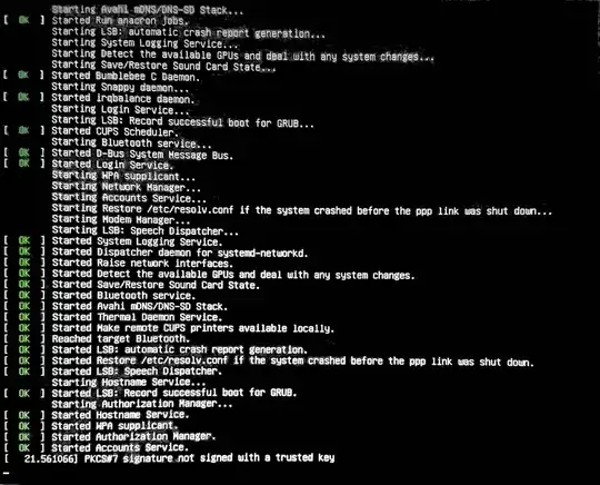

The problem now was that I wasn't able to change my brightness. I didn't see any brightness adjustment slider on the top, and neither the function key for brightness (Fn+F5, F6) worked. After I restarted upon installation, I tried to switch to nVidia proprietary drivers, hoping it would fix the brightness problem ( In Software & Updates -> Additional Drivers). That made it even worse. The log that is shown during Ubuntu's boot crashes and my laptop's fan begins to run at crazy speeds. There was no hard disk access when that happens (the hard-disk access light stops glowing). I had to hard press power button to force shutdown. I tried Bumblebee, same problem. I tried uninstalling nVidia drivers on recovery, but it still didn't fix my problem.
One thing that quite often popped up while booting Ubuntu (17.10, 18.04) was these two errors:
  1. TSC_DEADLINE disabled due to errata. Upgrade microcode firmware to 0x52.
  2. ACPI Error : AE_ALREADY_EXISTS
The above situation (Ubuntu crashing after Nvidia driver install) is rectified when I set acpi=off in GRUB. But this renders my touchpad unable to use, and I could not shut down my system without having to press the power button. The brightness adjustment slider wasn't there either.
