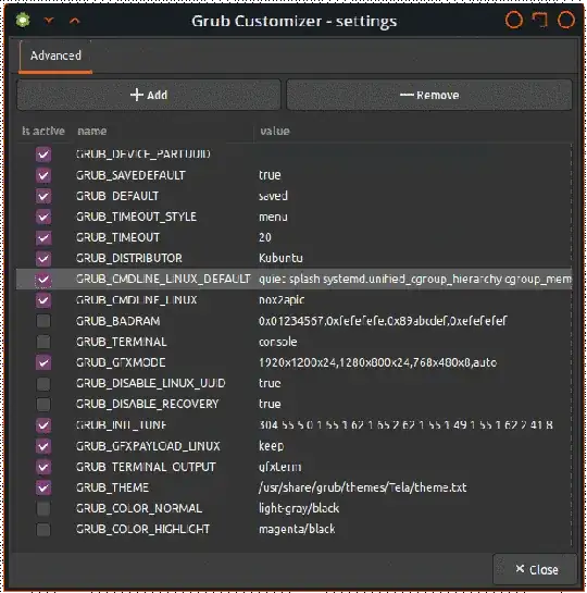

An alternative to editing the /etc/default/grub file directly is to install and use GRUB Customizer, which exposes these same variables in a thoughtful GUI layout. Installing it is simple if you're using a recent release (19.10 "Eoan Ermine" or later) of Ubuntu or one of its flavors like Kubuntu with sudo apt install grub-customizer in the terminal. It has an Advanced Settings dialog (shown below) that exposes the same values you need to modify in /etc/default/grub and keeps backups of modified files in case you need to revert the changes at some later time.
