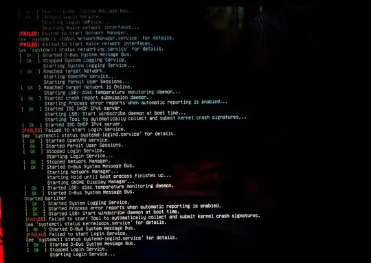

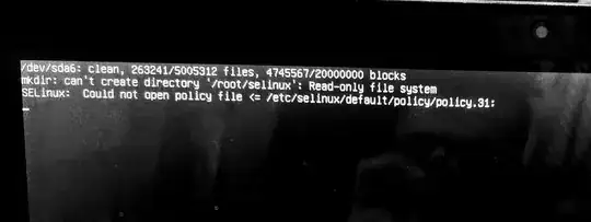

And then restarted my computer. The following images appear:
First thing that appears
First thing that appers
Second image
Second image
Note that this machine is dual booted with Windows 10.
After adding selinux=0 in the grub menu, I was able to gain back my PC running.
What am I missing here? What should I do? Should I uninstall SELinux or manage it to work properly?

SELinux is not fully supported in Ubuntu as they focus on apparmor and as already said by other people, it will probably require to adjust the policy.
But if you want to give it a try, you need to install an actual policy, here I see that you installed selinux-policy-dummy which is described as:
Empty Security-Enhanced Linux policy (dummy package)
This package is used to satisfy package dependencies, but does not contain an actual SELinux policy. This package should be installed if the system administrator is developing a custom SELinux policy.
You probably want to install selinux-policy-default instead, this package contains an actual policy, the system should boot a bit further. You also might want to check in /etc/selinux/config that the mode is set to permissive, that will make SELinux only log denials.
Edit: Also, try to install selinux-basic instead of selinuxpackage, the later is ubuntu specific and not maintained for years
