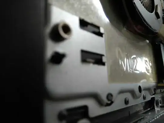

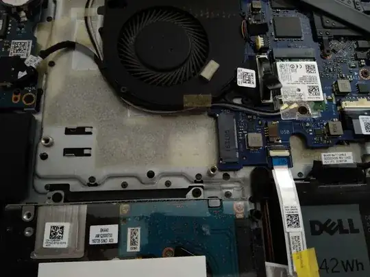

My laptop is a Dell Inspiron 15 7560. It only came with a Hard Disk. However after watching some teardowns of models like 7567 and doing some search online like this I could see that there is an empty M.2 SATA slot. Now these same slots are occupied by SSD in costlier laptops by Dell.

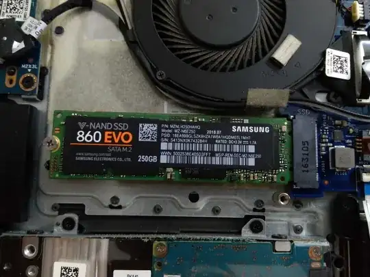

So I thought if i get an M.2 SSD and insert it there I will have a lot of space. So I bought a Samsung SSD - Samsung 860 EVO Series 250GB M.2 SATA Internal Solid State Drive (MZ-N6E250BW). Without the SSD - enter image description here It even had an imprint saying M.2 SSD - enter image description here After inserting the SSD (I am not sure if there is a polarity or if I inserted it the wrong way) - enter image description here

Putting nvme_load=YES boot parameter to GRUB is irrelevant because your M.2 SSD is SATA-III, not NVMe. You don't need any drivers for a SATA M.2 drive, they're already in your kernel. You attached it into your system correctly, as per the photos.
Instead, use gparted to prepare the drive so it holds an ext4 partition, and then move your /home partition there.
