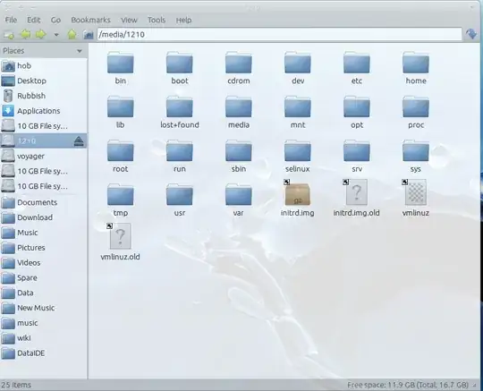

First you would need to have the files for the system you want to edit mounted.
Look in the left panel for the file system in pcmanfm (the file manager) and click on it - it will look 'similar' to this
You can see that I have mounted my 12.10 partition
Check what the path is called for you - could be /media/long UUID reference and then run
gksudo leafpad /media/longUUIDreference/etc/modprobe.d/blacklist.conf
from a terminal.
