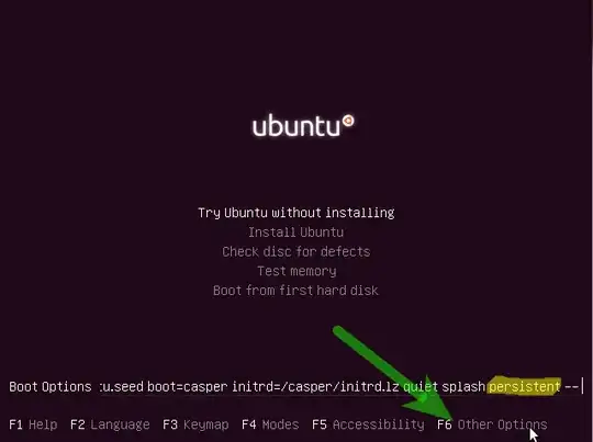

I've grabbed a screenshot from another question I recently answered - just substitute the word persistent as shown with the word noapic
To display this screen, immediately when you see the purple screen with the symbol at the bottom (seen immediately after the boot sequence starts) press Esc... If you got to the "try ubuntu screen" you missed the opportunity!
When you press F6 a pop-up menu will display. Press Esc to make this menu disappear then use the keyboard arrow keys to move to the position shown in the picture.
