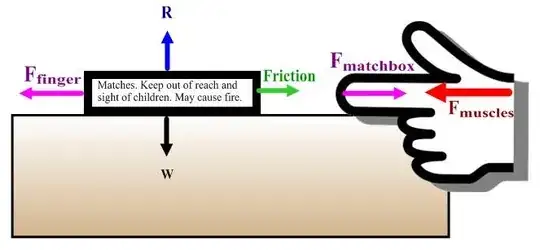

Here's a picture of some of the forces in this scenario.$^\dagger$ The ones that are the same colour as each other are pairs of equal magnitude, opposite direction forces from Newton's third law. (W and R are of equal magnitude in opposite directions, but they're acting on the same object - that's Newton's first law in action.)
Finger Prodding Matchbox
While $F_\text{matchbox}$ does press back on my finger with an equal magnitude to $F_\text{finger}$, it's no match for $F_\text{muscles}$ (even though I've not been to the gym in years).
At the matchbox, the forward force from my finger overcomes the friction force from the table. Each object has an imbalance of forces giving rise to acceleration leftwards.
The point of the diagram is to make clear that the third law makes matched pairs of forces that act on different objects. Equilibrium from Newton's first or second law is about the resultant force at a single object.
$\dagger$ (Sorry that the finger doesn't actually touch the matchbox in the diagram. If it had, I wouldn't have had space for the important safety notice on the matches. I wouldn't want any children to be harmed because of a misplaced force arrow. Come to think of it, the dagger on this footnote looks a bit sharp.)

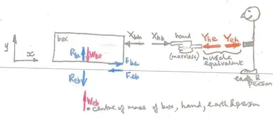

I have added a few additional forces to the diagram produced by AndrewC to show 5 groups of forces which are Newton's third law pairs and made the hand massless to simplify the diagram.
The Newton's third law pairs are colour coded and labelled.
These pairs of forces:
  • are equal in magnitude and opposite in direction
  • act on different objects
  • are of the same type ie both contact, both gravitational etc.
For example $R_{\rm be}$ is the reaction on the box due to the earth and its Newton's third law pair is $R_{\rm eb}$ the reaction on the earth due to the box, $W_{\rm be}$ is the gravitational attraction on the box due to the earth and $W_{\rm eb}$ is the gravitational attraction on the earth due to the box.
The $F$ forces are the frictional forces between the box and the earth, the $X$ forces are the contact forces between the box and the hand, and the $Y$ forces are the forces on the hand and the person and the earth as a result of the action of muscles in the arm.
If the system is assumed to be the box, the hand and the person & the earth then the net external force on that system is zero and the centre of mass of the system does not undergo an acceleration.
Looking at vertical, y-direction, forces acting on the box alone system and applying Newton's second law gives $R_{\rm be} - W_{\rm be} = 0$ and the equivalent equation for vertical forces acting on the person & earth system is $R_{\rm eb} - W_{\rm eb} = 0$ so the box and the earth do not accelerate in the vertical, y-direction.
Now consider the forces acting on the box in the x-direction and apply Newton's second law $F_{\rm be} - X_{\rm bh} = m_{\rm b}a_{\rm b}$ where $m_{\rm b}$ is the mass of the box and $a_{\rm b}$ is its acceleration.
Now if the left hand side of this equation is zero the box could be at rest or moving at constant velocity.
If the left hand side of the equation is no zero then the box will accelerate and if the force on the box due to the hand has a larger magnitude than the frictional force on the box due to the earth then the box will accelerate to the left.
So even though you have all these Newton's third law pairs supposedly cancelling each other out they do not because the act on different bodies.
For the hand system the equation of motion is $X_{\rm hb} - Y_{\rm he}=0$ which means that the magnitude of the force on the box due to the hand $X_{\rm bh}$ is equal to the magnitude of the force on the person & earth due to the hand $Y_{\rm eh}$.
And of course even though you would notice the effect because the earth is so massive, the person and earth system of mass $m_{\rm e}$ would suffer an acceleration $a_{\rm e}$ in a direction opposite to that of the box given by the equation $Y_{\rm eh} - F_{\rm eb} = m_{\rm e}a_{\rm e}$.
Note that the magnitude of the force the person & earth system is exactly the equal to the magnitude of the force on the box system.
