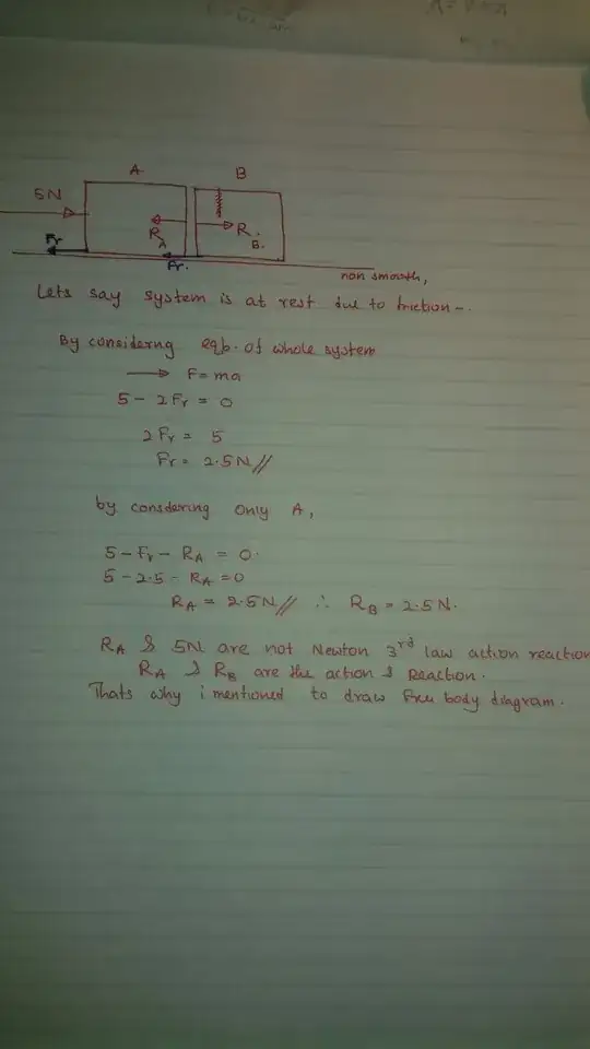

This is the answer for one of previous question,
It should be "Every action has equal and opposite reaction of SAME TYPE" , the best way to understand these contact force related questions is to draw a large clear free body diagram. Which will eventually lights up your problems.
Draw all possible forces on both object(s) and or contact surface.
Pls see the image , the force you applied is not belong to the action, it is a separate force, action reaction forces are (Ra and Rb) their magnitude remains equal regardless of situation (acceleration, declaration, constant velocity etc) , and those are the action reaction pair, not the force you applied on the body.
If you are concerning about the reaction force due to 5N force applied on the object A , it will be acting on your hand which is still 5N acting opposite direction. Also to clarify your concern, newton pair of force always acts on different bodies not on the same bodyenter image description here
