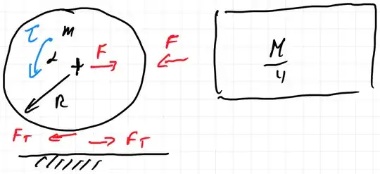

from the free body diagram you see that the car move due to the constraint force $~F~$ between the wheel axel and the car suspension, for a static case this force is equal to the force between the wheel and the road $F_T$
  • $~\tau~$ Engine torque (transmitted to the wheel)
  • $~F~$ constraint force
  • $~F_T~$ Tire force or constraint force (in case of no slip between the wheel and the road)
  • $~I_W~$ wheel inertia
the equation of motion for the car acceleration $~\dot v_C~$ and with "no slip condition" is:
$$~\frac{M}{4}\dot v_C=F\\ F=\frac{M\,R\,\tau}{R^2(4\,m+M)+4\,I_W}$$
