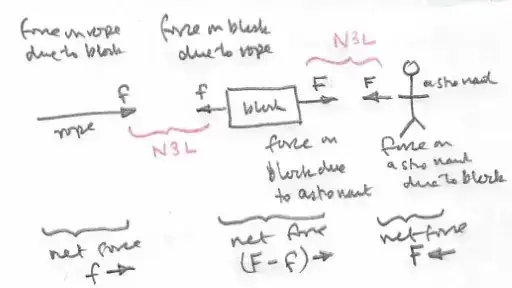

Consider three separate systems, the rope, and the astronaut with the free body diagrams as shown below.
The net force on the block is $F-f$ to the right.
