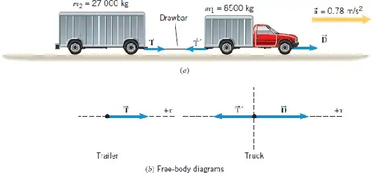

Well, the same thing happens with the horse/cart scenario, except that the horse has the ability to resist the reaction force because it is in contact with the ground. The cart itself rolls on wheels and will start to go when pulled - if we ignore friction, and vertical forces (gravity, normal force), there's a single, non-zero force acting on it. So why the cart moves is not mysterious. Of course, the horse moves as well, and the two act roughly as a unit, so we can say that both the horse and the cart have the same acceleration. For this to be true, the horse needs to produce a forward-directed force, larger in intensity than the reaction force, so that the net force on the horse provides that particular acceleration (the image below I found here shows a similar situation; it ignores friction, drag, etc.).
One point that's perhaps counter-intuitive is the fact that the forward-directed tension force doesn't have the same magnitude as the propulsion force $\vec{D}$ produced by the horse/truck.
If $\vec{F}$ is the net force on the horse/truck, note that $D = F + T = m_1a + m_2a = (m_1 + m_2)a$, so if you consider the system as a whole, $\vec{D}$ acts on the combined masses of the two objects, while internally the tension $\vec{T}$ only acts on $m_2$. (Note also that in this model the objects are treated as if connected by an idealized massless cord.)
