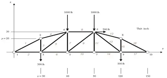

In fact, there's a branch of mechanics concerned with (static) applied forces that (vector) sum to zero so that there's no net force and, thus, no acceleration.
For example, consider the analysis of a truss in a steady state condition.
Image credit
Note that there are applied forces and yet the truss is static.
