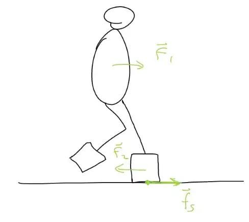

To understand things more clearly, we can take a closer look and take a few things apart. Let us zoom in on my drawing containing the "stick figure with brick shoes." I will depict horizontal forces only.
When one foot is on the ground and you are in your swing phase, your body is applying a force onto your grounded foot pulling it backwards. By Newton's third law there is a reaction force from your foot onto your body pulling the body forwards.
In the absence of friction, your foot and body will just switch which one is in front without any change in your center of mass. However, because there is static friction onto your grounded foot canceling out the force your body is applying, the grounded foot stays in place while your body is able to "swing" itself forward. Once your body gets in front of your grounded foot, you managed to make one complete step.
