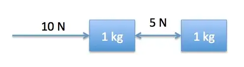

Acceleration gives rise to an additional force - if I push onto a 1 kg mass with a force of 10 N, it will accelerate at 10 m/s/s. But if I put a second mass in front of the first, their total mass is 2 kg and when I push with a force of 10 N, they will accelerate with 5 m/s/s. If we look at the forces in the system we see:
Somehow, the left hand object "absorbed" 5 N of force, with 10 N on the left and 5 N on the right. This is because the object is accelerating. At every point there is balance. On the left, the 10 N from my hand is feeling a 10 N push-back (reaction force) from the first block; in the middle, the blocks have an action-reaction pair of 5 N. There is no contradiction here.
In the case of your hands pushing, it's the same thing. If one arm is pushing harder than the other, your hands will move in the direction of the weaker arm; at every point in the chain forces are balanced, but where there is accelerating mass there will be a change in force along the chain.
