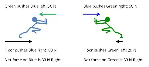

Similarly, this website (http://resource-bank.nzip.org.nz/draft-under-construction/mechanics/newtons-third-law-misconception-2/) tries to explain this concept with the following diagram: Forces between two bodies

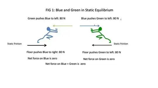

It does not make sense to me, why if the floor pushes on blue by 80N, that the forces exerted between blue and green is not also 80N (and hence why the forces exerted between green and the floor is not 80N).

In fact the forces would all be the same if blue and green were in static equilibrium, i.e., if blue and green were not accelerating. See FIG 1 below. Then the static friction forces acting on blue and green, which are external forces acting on the combination of blue and green, would have be the same. So if the static friction force on blue is 80 N then it has to be 80 N on green as well in order for the combination of blue and green to be in equilibrium. Then, since blue and green are also individually in equilibrium the net force on each individually also has to be zero per Newton's 2nd law. Therefore the force that each exerts on the other would also have to be 80 N.

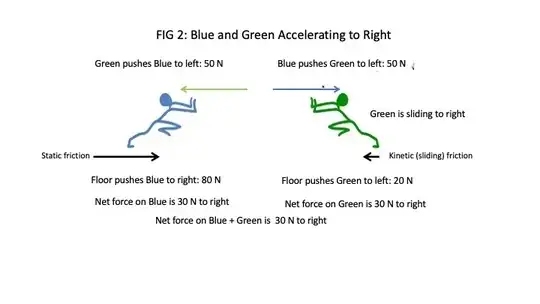

In this example, however, the maximum possible static friction force between green and the ground has apparently been exceeded while that for blue has not. See FIG 2 below. We know this because a free body diagram (FBD) on green alone shows a net force of 30 N to the right, meaning green is accelerating to the right in a direction opposite to the direction of the friction force. That means Green is sliding and the friction force has changed from static to kinetic, or "sliding" friction.
Blue, on the other hand, is accelerating to the right in the same direction as the static friction force acting on it. Only static friction acting as an external force can cause acceleration. The everyday example is the static friction force between a car's drive wheel an the road acting forward on the car causing it to accelerate.
